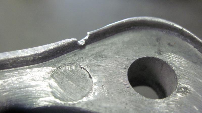

The next step is to do a 454-455 conversion thread....

I never liked those valve covers. I ran a set back in 02-03, and though they were not cracked, they were a pain to get on. Bolt holes didnt line up for crap. How hard does it have to be to put a valve cover on for pete sake. Never again

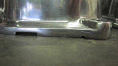

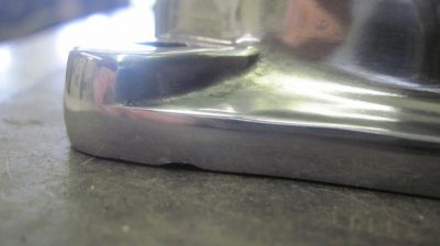

natas, I really wish you had taken a minute to READ my post -- and maybe even look at the pictures and captions -- first before tossing out your reply. The valve covers that are the subject of this post are brand new and have never been bolted onto anything.
yes sorry I didn't take the time to read it through thoroughly, i assumed they were used. funny thing is maybe they are, they could have been bought and someone realized they broke them and returned them to the supplier for a refund saying they changed their mind on the parts. or some covers have been dropped onto the floor possibly by someone.
reason i say this is, I can see an aluminum casting having many flaws, porous, chunks missing, but being cracked on the corners like that, it is just too suspiciously exactly what happens when they've been (over) tightened onto a cylinder head.
Not surprisingly, that's exactly what the 60+ people who've responded to my posts with their own cracked / broken dog ear / leakage horror stories thought too. With just two days' exposure on this 'development,' I really don't like the numbers I'm reading about.
Sounds like someone didn't do a quality control check before installing them?i guess Mopars are junk then. they made a stupid valve cover and we should all convert to Ford and Chevies. yes im being sarcastic. no not towards you. just in general. the covers are about the only thing I could personally fault from Mopar Performance for not being totally bulletproof, other than some batches of bad cast aluminum heads, which EVERY manufacturer has had, even the most expensive, even today. a guy with a small block chev just recently bought $4000 worth of the latest design BRODIX heads for a radical small block build and the engine went on the dyno and both of the heads were literally watering the dyno room, it was the newest and most powerful sprinkler system on the market, sold new by BRODIX. even NETAFIM would have liked the design, they watered all 4 corners of the room in a nice even pattern :app:

Looks like something was dropped......and pretty hard lol
Thanks, Leanna. I have the MP aluminum valve covers and cast iron heads. I have been "chasing a leak" at the passenger side valve cover. I tried the Moroso Perm-Align gaskets with the metal inside and the thick cork gaskets, both leaked. I give up. I think I'll try steel valve covers next.
Does anyone besides me torque their valve cover bolts to spec? Maybe I'm too ****. But I never broke an ear off an aluminum valve cover.
