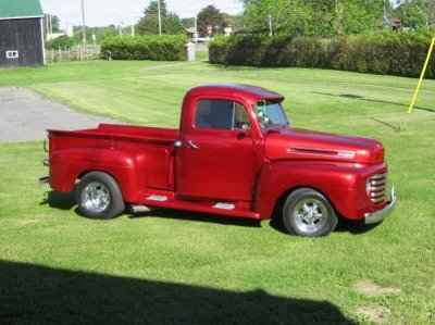

i am not a fan of cross breeding. when i am at a cruise or show and see some stuff where there has been 100's of hrs and 1000's of $ spent and its cross bred i walk on. when this truck was done he was thinking s/b chev but a bunch of us buds talked him out of it. now that i own it i am proud of it with the 5lt. h/o, c6 and 9".
this all just my opinion and opinions are like ********, everybody has one.
ps; yea i know its a mopar site but trying to make a point.

we are very similar situations. i inheirited the the truck when he passed. good luck. rick
