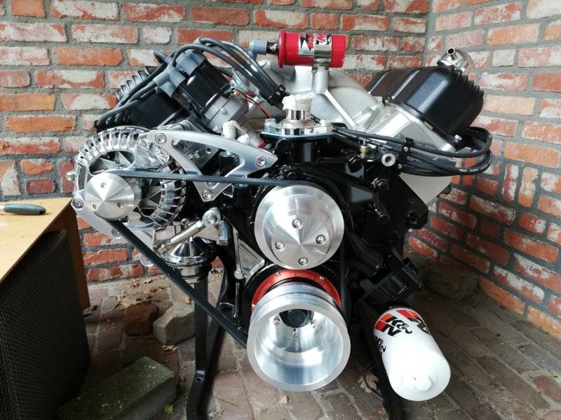

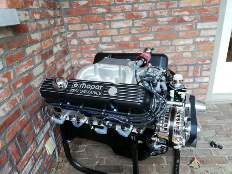

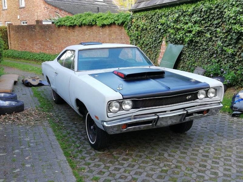

Hello Everybody,

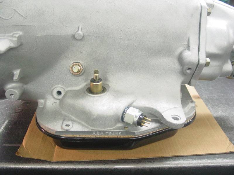

I'm in the process of building a Dodge coronet 1969 Super bee Pro touring. I've started already some time ago. I already bought a professional build 500CI stroker enginge, 727 freshly build by A&A, Hotchkiss TVS kit, 11'' disc brake kit. I will keep an overview of the things that are going to be used below for eacht department. The car was originally B5 blue, i'm not sure which colour it will get. I'm thinking now of a shade darker of B5 or Hemi orange, i have a a12 hood that I will use.
Engine:

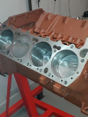

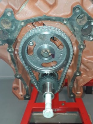

500CI Stroker engine, specs will follow have to look them up
Trans:

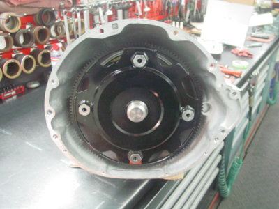

727 build by A&A
I'm considering to get a gear vendor for overdrive, 3 gears is not much…

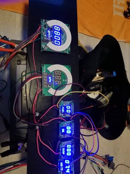

Intellitronix create a dash (will be made into the rallye dash)

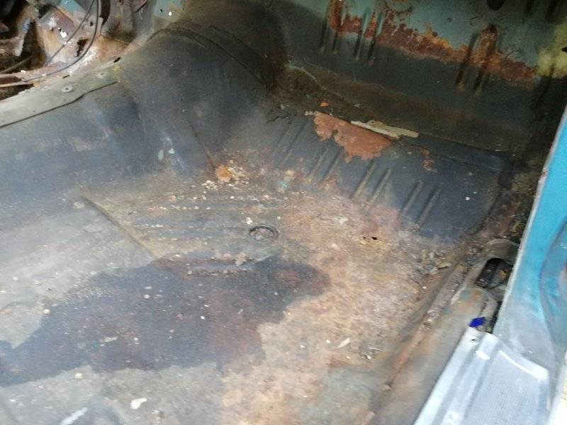

New AMD:
- One piece Trunk & extensions
- L & R quarter panel
- Full floor
- Inner and Outer rocker
- Window gutter repair
- Trunk gutter pieces.

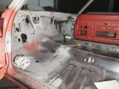

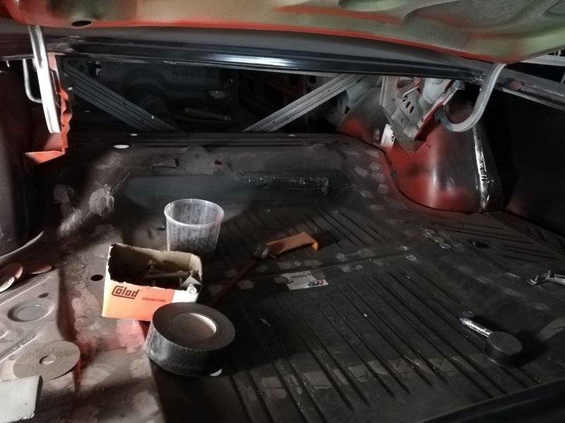

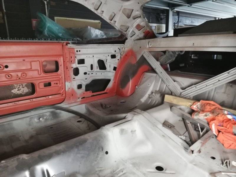

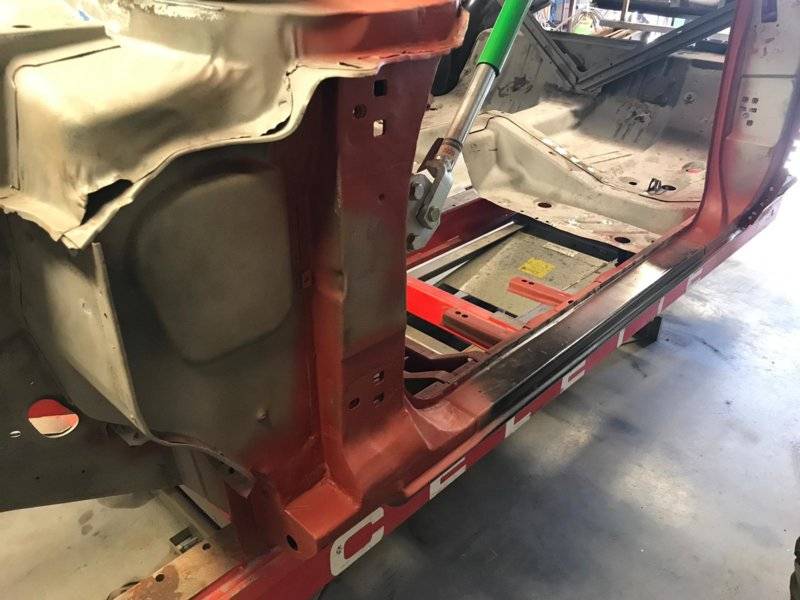

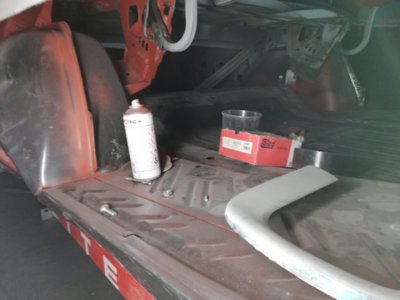

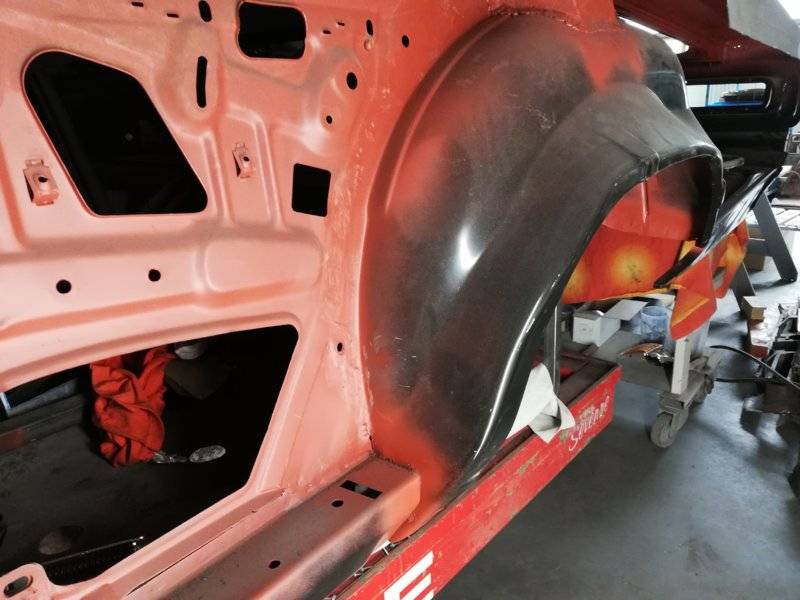

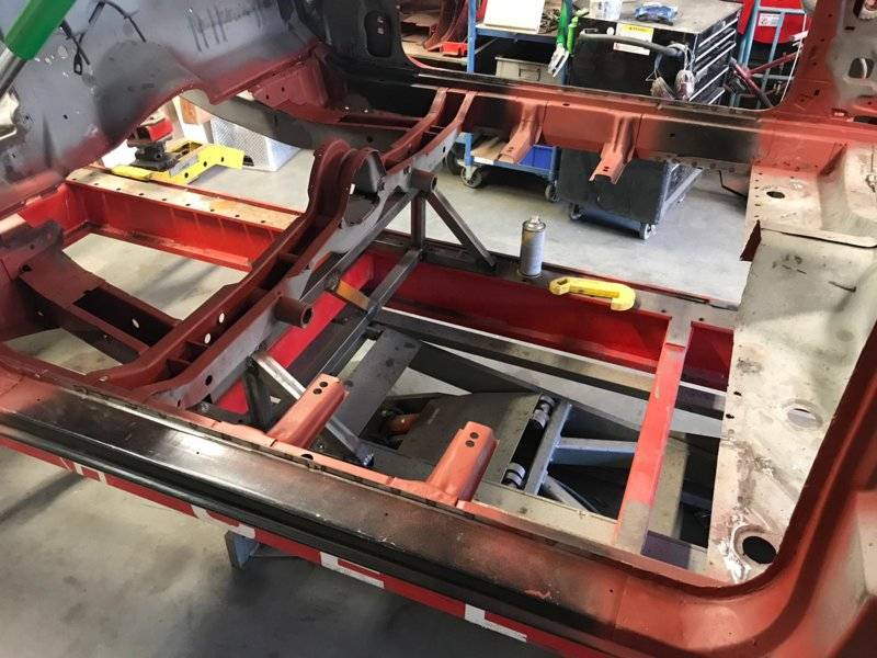

The body was blasted first and is now alredy for some time at the bodyshop.

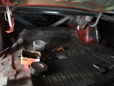

They are almost ready with the sheetmetal, after that i will let them install the UScartool stiffening kit i bought and the Hotchkiss subframe connectors.

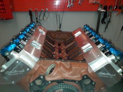

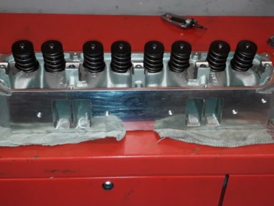

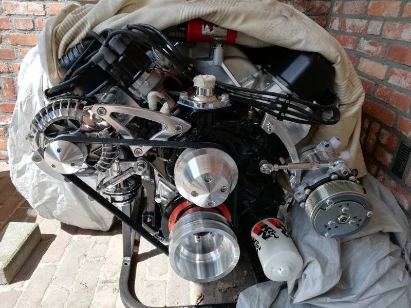

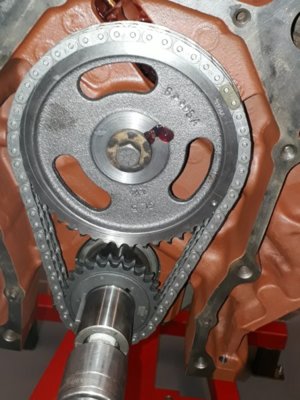

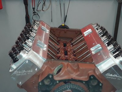

I installed the spark plugs separator. Looks nice and clean. I want to buy the headers now. Which one should I choose? The TTI?

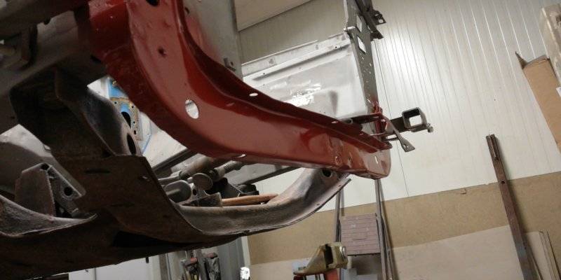

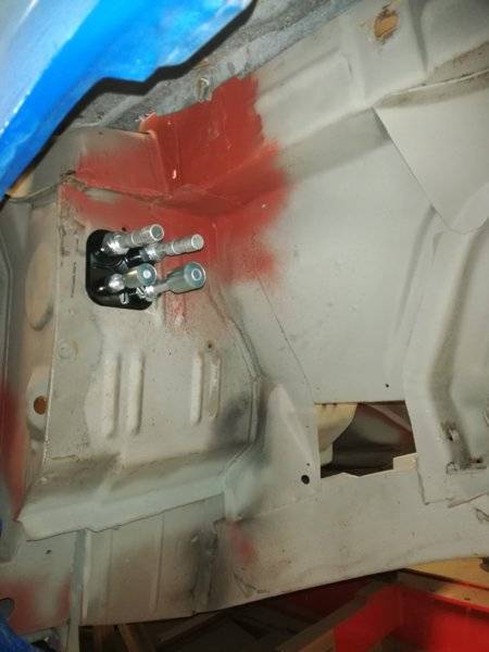

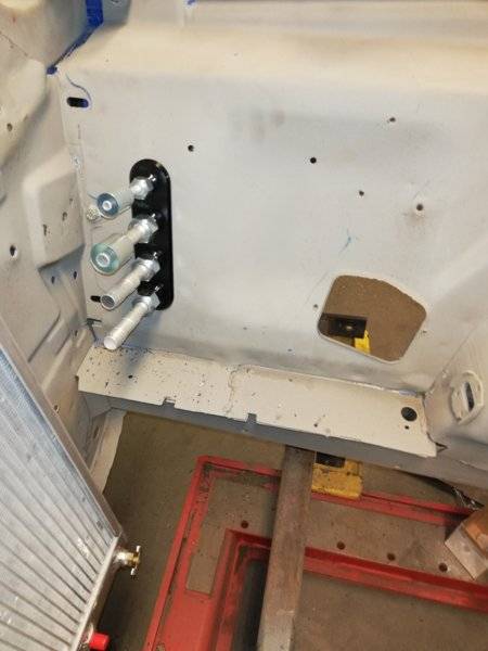

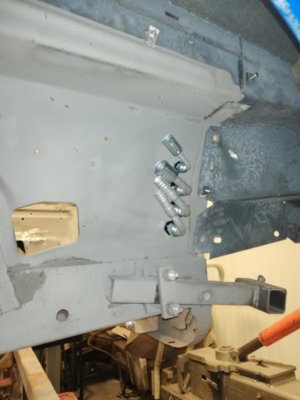

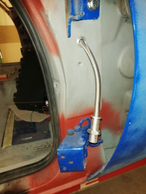

Been a productive day today. Mounted the bulkheads for AC and heater and for wiring harness. All routed under the fender. And installed the inner fender braces and front brace from us cartool. I welded the front brace myself with co2. Was my first weld ever. Still have to smooth the welds out. And attached the door looms to run the cables to door through.
IMG_20190813_082349.jpg IMG_20190813_082331.jpg IMG_20190813_082324.jpg IMG-20190813-WA0008.jpeg IMG-20190813-WA0010.jpeg IMG-20190813-WA0013.jpeg IMG_20190813_095555.jpg
