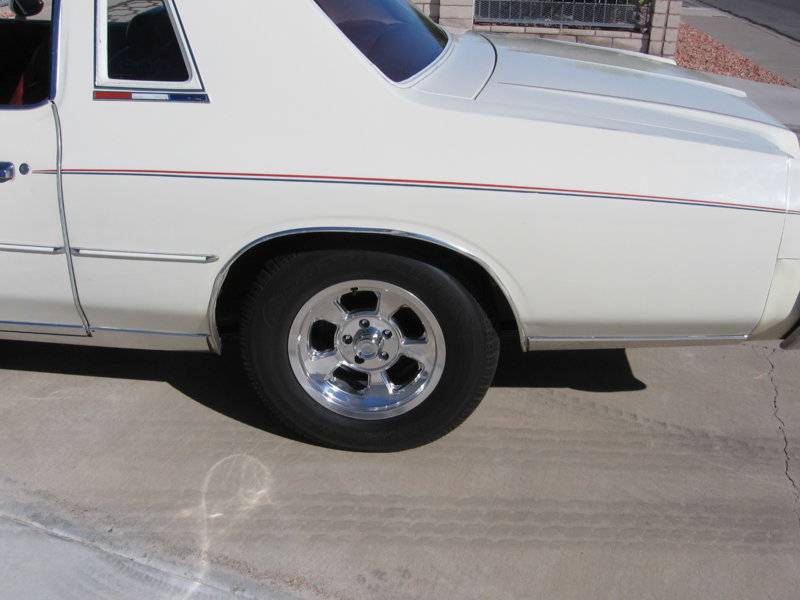

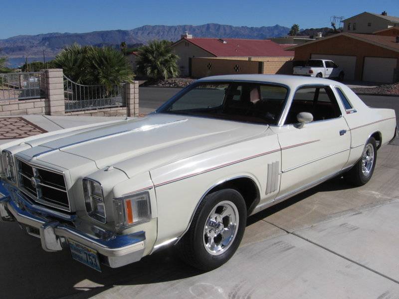

If you look at both cars fenders,doors,quarters,you will see the difference. Magnum has bulges that flow into the doors from the front fenders and doors to quarters. The Cordoba (300) does not. Deck lids may be the same looking at the photos.
View attachment 642363 View attachment 642364
