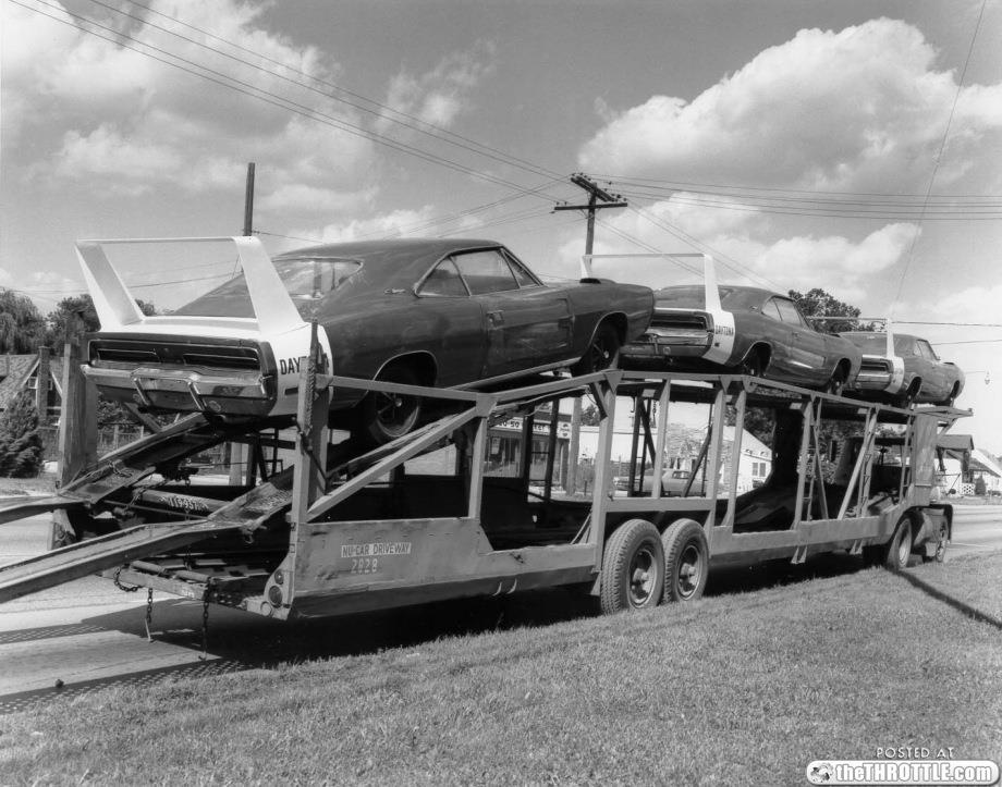

I also have a photo of Daytona's being delivered which have this trim, so it's not specific to any certain trim level of charger.
The M25 Wide Sill Molding option was a stand alone option and not included in any option package.
