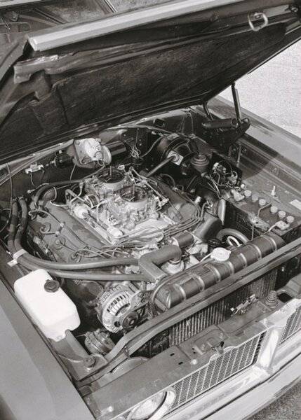

Please understand that I run my hoses crossed as in that excerpt shown above. But, if it makes a difference then Chrysler needed to do a better job of training their own assembly line workers as many of the pictures in period magazine road tests and pictures of very low mileage, unaltered originals show their hoses not crossed. From Peterson photo archives of early (1965 assembly) Hemi Coronet Coronent put together for the press and road test pool.
