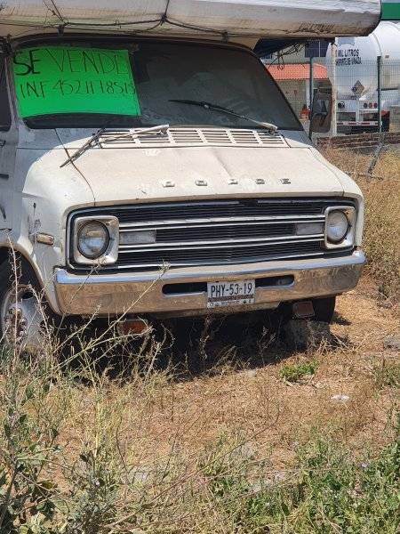

Does this motor home has a 440 in it?

Already talk to the owner and I explained to him that the only valuable asset from that pos is the engine and transmission and if it has the motor that am looking for ill buy the motor another question would be if it has the 440 how much is a fair price for both, thanks in advance
The pictures don't come up.
Just look for the location of the oil filter. Up front below the power steering pump? That is a Big Block and could be a 383, 400 or 440.
Most are 318 and 360.. but the odd one has a 440 in it. I was looking for one to make into a hauler and noticed about one in twenty had a 440 in it. Open the damn hood...

distributer up front left & engine ID pad on the front right
1978 or earlier, it "may" or "could" be a 440,
they have a 26" radiator & trans-cooler upfront too
(440's were more for the 'Class A' Motorhomes, but were installed in some 'Class C' too)

in the Latin market I doubt it is a 440...
Maybe unless it was from up north to begin with
A distributor in back, an LA series small block
more than likely a 318 or 360 'maybe'

Ya se, apenas hable con el dueño y la porquería esa esta abandonada al lado del camino, ni sabe que motor tiene y quiere 4k por eso le dije que no qué le doy menos mucho menos y si y solo si tiene el 440 la cada rodante estaba cerrada y me van a prestar las llaves para abrir el cofre y ver que tiene adentro.
