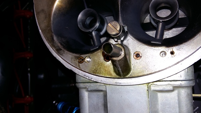

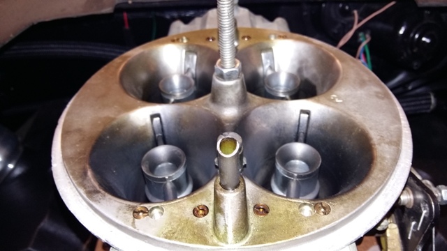

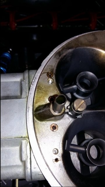

If you look at the top of it you'll see the air bleeds how many per venturi? 2 is a 2 circuit 3 is a 3 circuit.
Hi,
it is a 3 circuit. On each venturi it have 3 air bleeds.
But the crazy thing is that somebody have removed the intermediate air bleeds on all 4 venturis!!?
