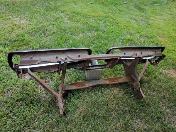

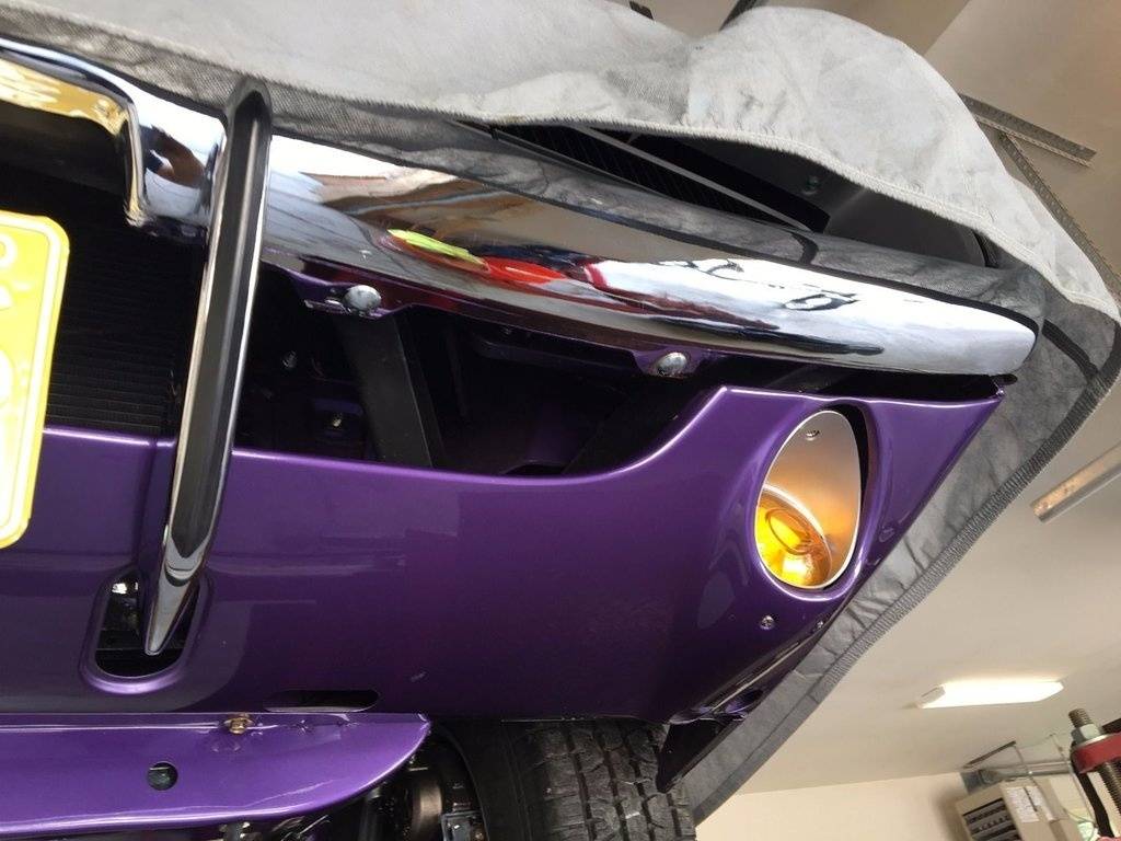

I will be installing front bumperetts on my 70 charger. Is there a support that holds the lower end of the front guards. Maybe positioned inside the lower front valance? If so what is it commonly called and how hard is to find this support? It is hard to find something when I don`t know what I am looking for. Pics would help.

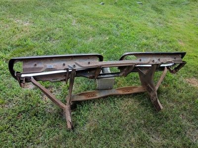

Here's a pic of a 70 Coronet. Same deal though. Upper/Lower reinforcement, bumper brace connecting the two inner/outer supports.
