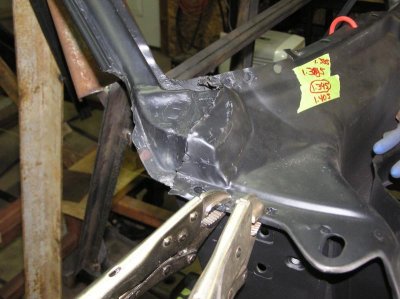

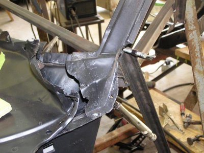

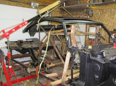

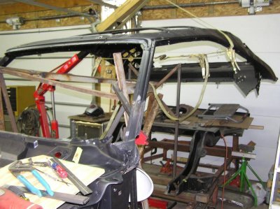

Ok now that I have the a-pillars tacked on it is time to join them to the front clip at the lower cowl. Remember, I had rotated the front clip out of the way so I had room to join the a-pillars. Now that I had them roughed in, I lifted and sat the front of the roof support on 4x4's (to clear the cowl) while I rotated the front clip back into position.

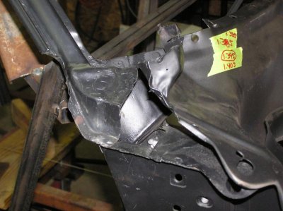

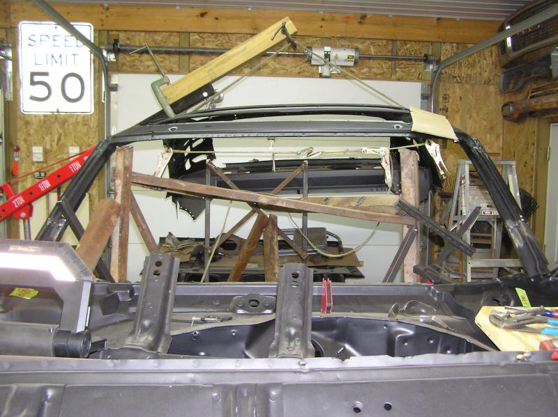

Next I needed to lift the entire roof support with the the back end higher than the front so I could kind of "hook" the knuckle end of the a-pillars into the opening of the upper cowl. (Hope your following me) This would be a real pain in the rear by myself, and I didn't have 3 freinds to call (1 on each corner) so this is what I came up with ...............

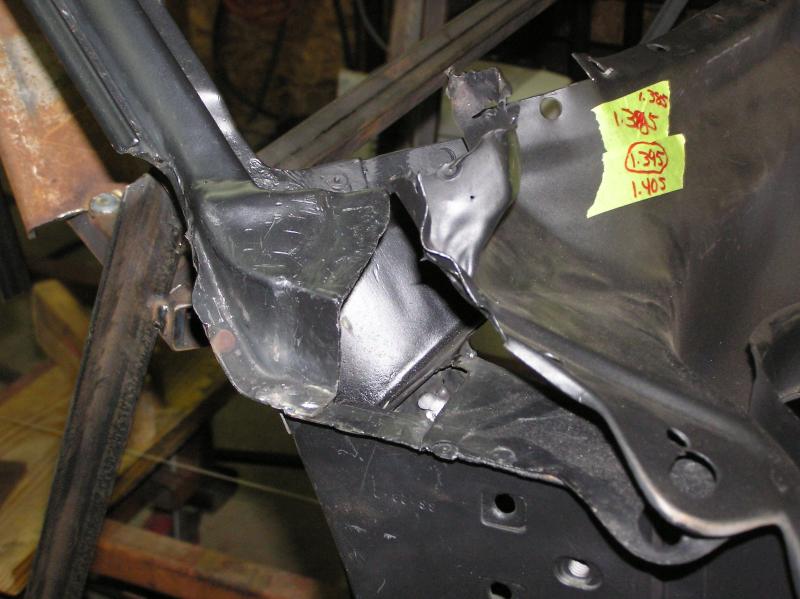

In this pic you can see how the a-pillar knuckle is hooked in.

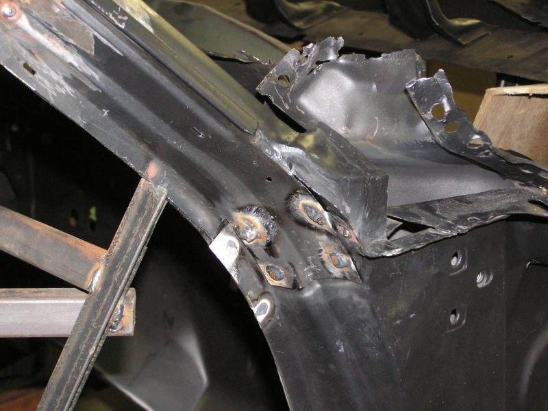

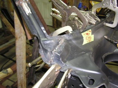

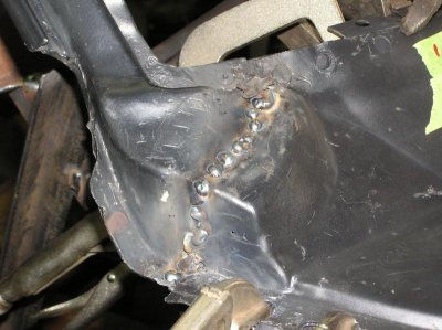

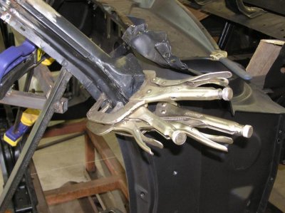

Attachment of a-pillars to cowl

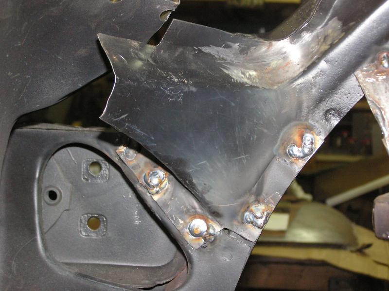

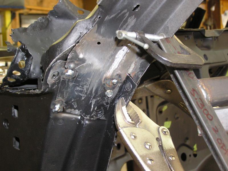

Now that I have the roof back on the jig. Its to time to permanatly attach the a-pillars to the cowl.
Notice that I had to peel back the upper cowl so I could get the "knuckle" of the a-pillar to seat

Don, thanks for posting those closeup pics of the a-pillars. I've started repairing that section on my car and it was so rotted out that I couldn't tell the a-pillar from the door support and I have a lot of gaps in that area. Looking at yours I can see exactly how it fits together. you were a huge help and you didn't even know it. You Rock!
Thanks BB61, I learned a few things myself. I think the biggest thing is not to be afraid of fixing this area. Just take your time, plan it out as best you can, and go for it! It would be nice if AMD came out with the metal to fix these, I spent a LOT of time on this.
