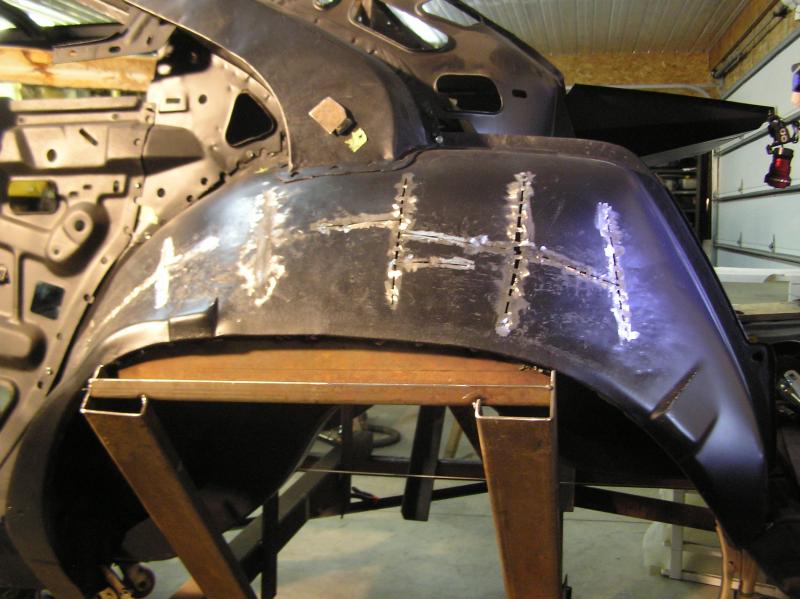

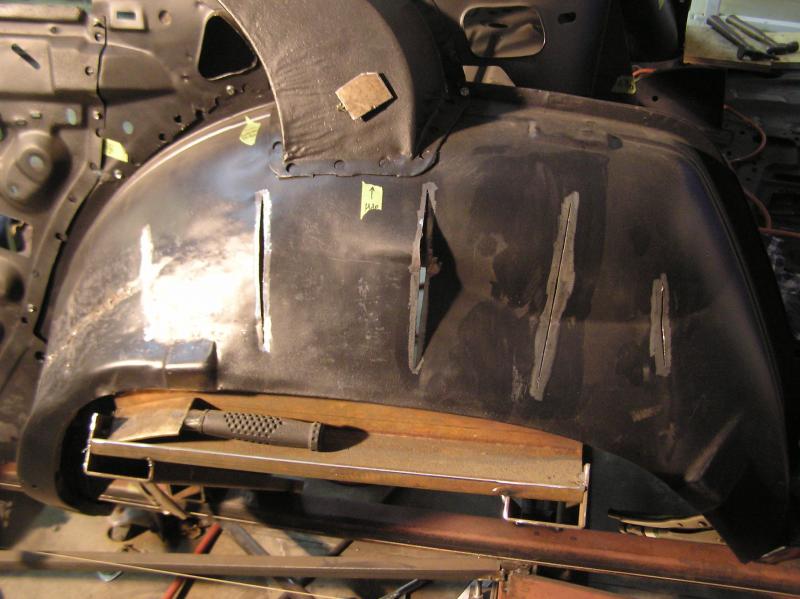

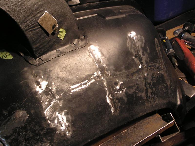

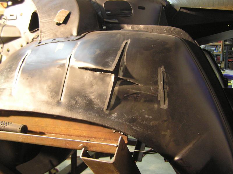

Drivers side de-hump

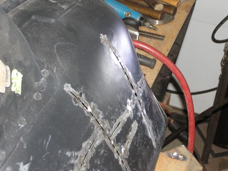

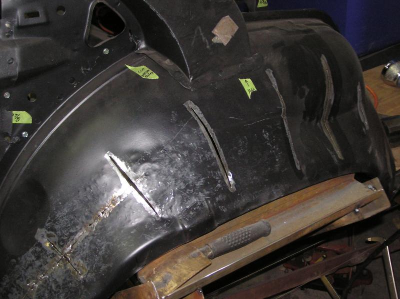

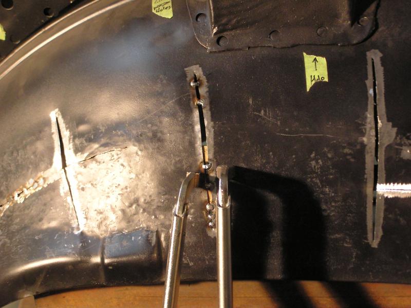

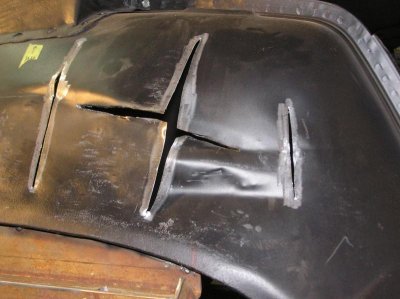

Continued with the slicing and hammering.

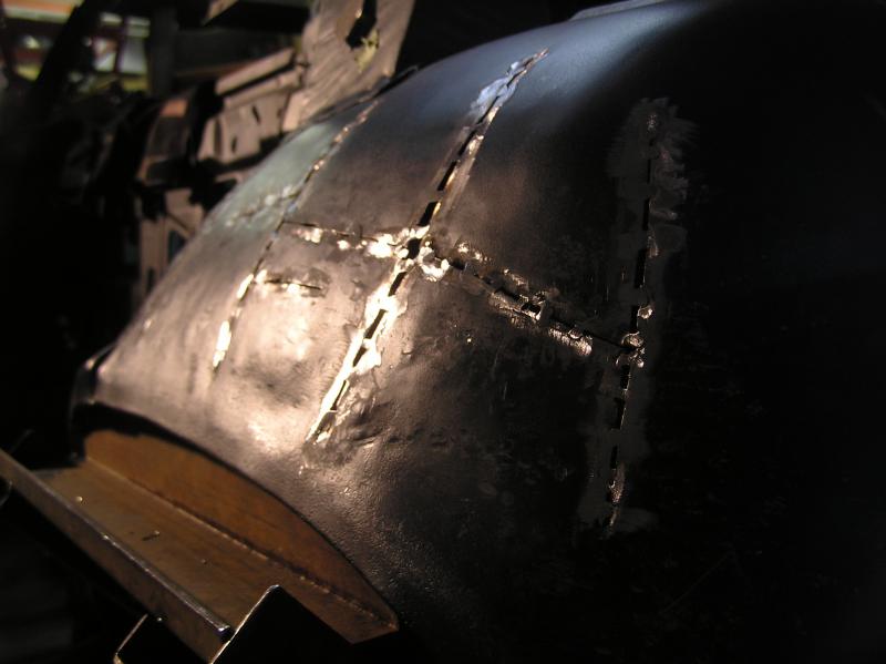

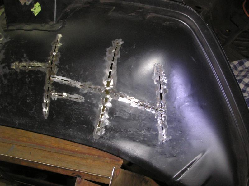

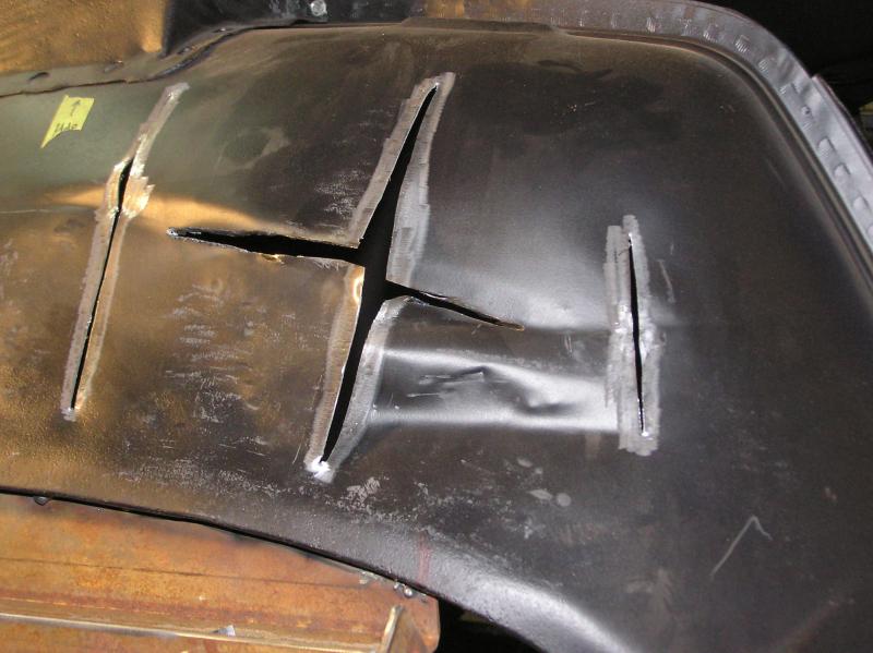

Here you can see how the metal is puckering when it is hammered out.
I sliced the metal horizontally to help this situation

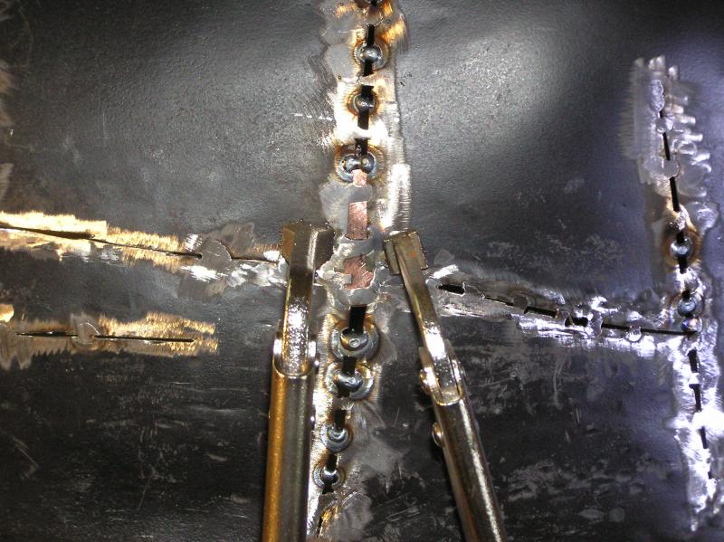

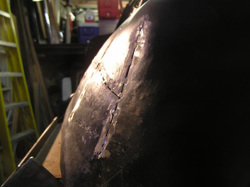

Then I started welding it back together.
Here you can see the copper spoon I used as a backer.

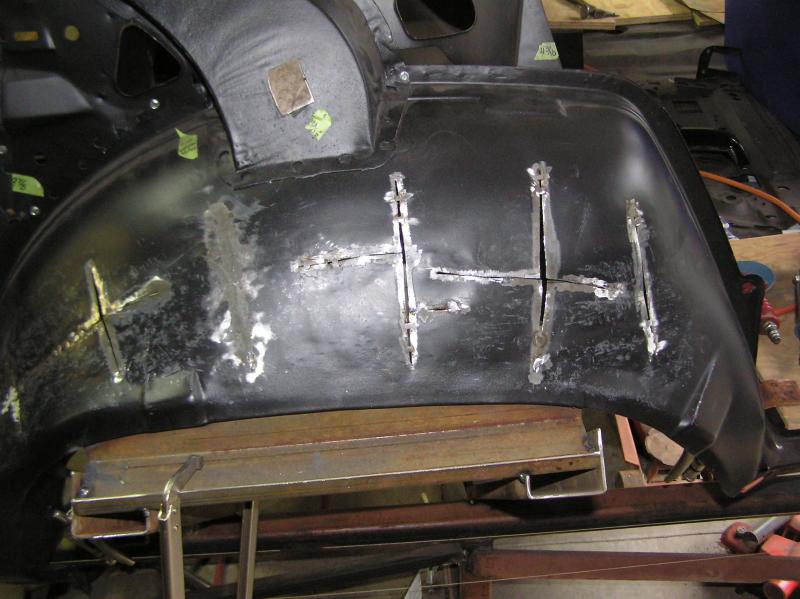

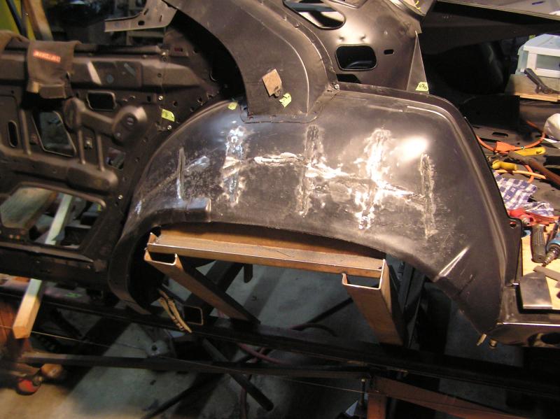

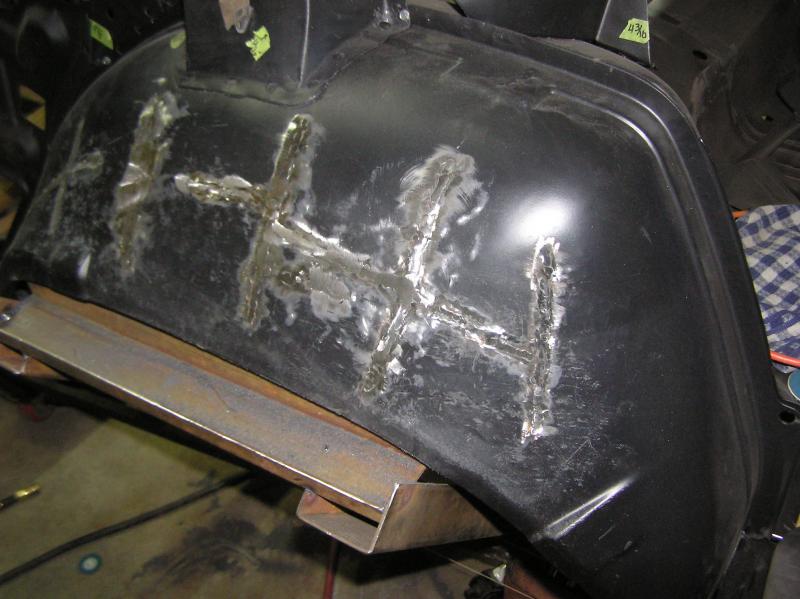

The profile looks pretty good
Some of the gaps opened up quite a bit from the hammering
My good ol trusty copper spoon!

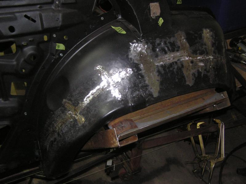

ALL DONE with this side and I am very pleased with the results!
If I were to do it again, in my opinion making vertical (up an down) slices and hammering out the crease is the way to go!

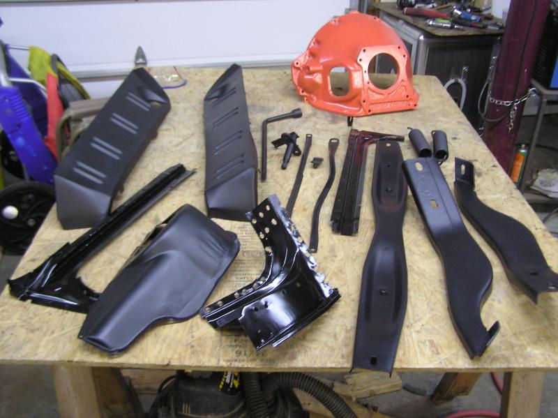

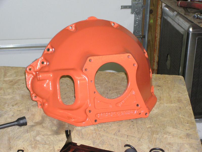

I primed a few more parts

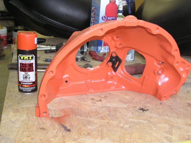

I Painted the bellhousing with this VHT hemi orange paint. I plan on using this for the engine block when it comes time. Hope it's the right shade.

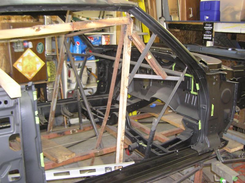

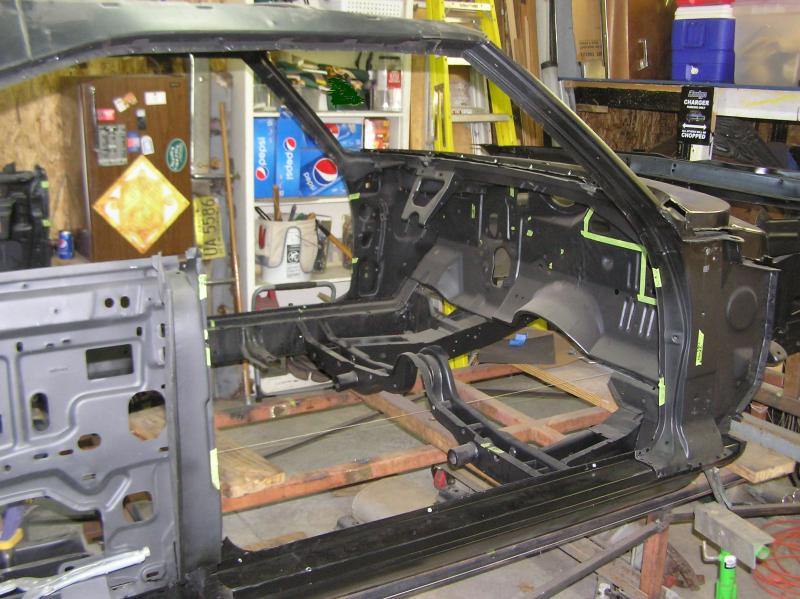

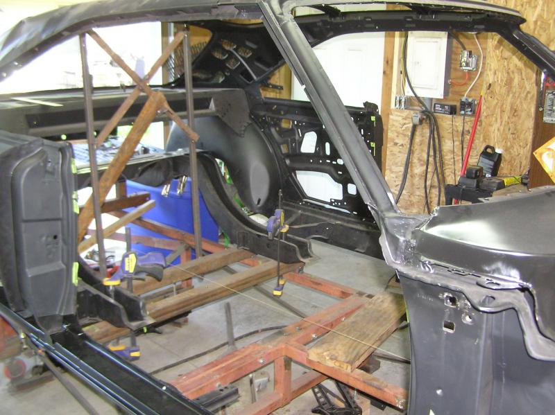

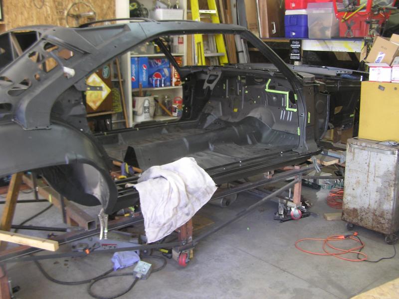

I reached the point where it was time to remove most of the bracing.
Now you see it
Now you don't
It's ALL gone!
And WOW does it look different!
Left this bracing in to support the back half of the roof
It will stay untill I get the wheel wells welded to the rockers

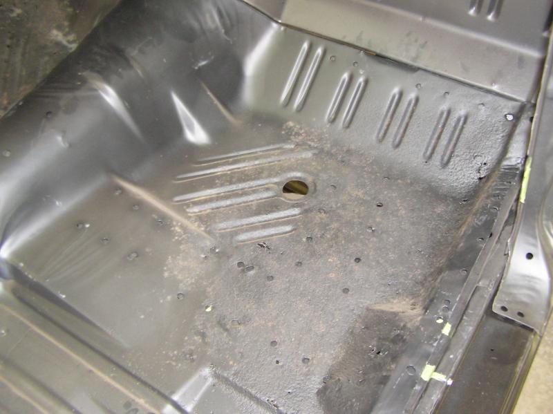

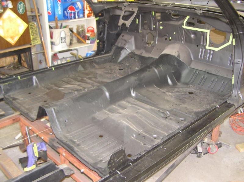

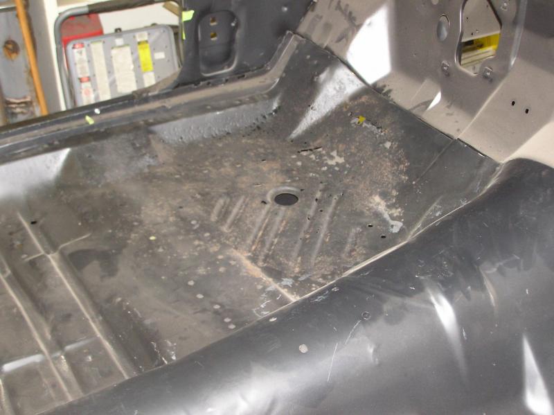

With the bracing out of the way I could start work on the floor
This needs a new section as well as the driver side
