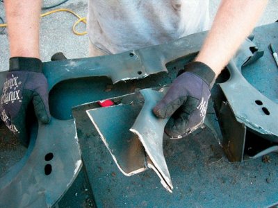

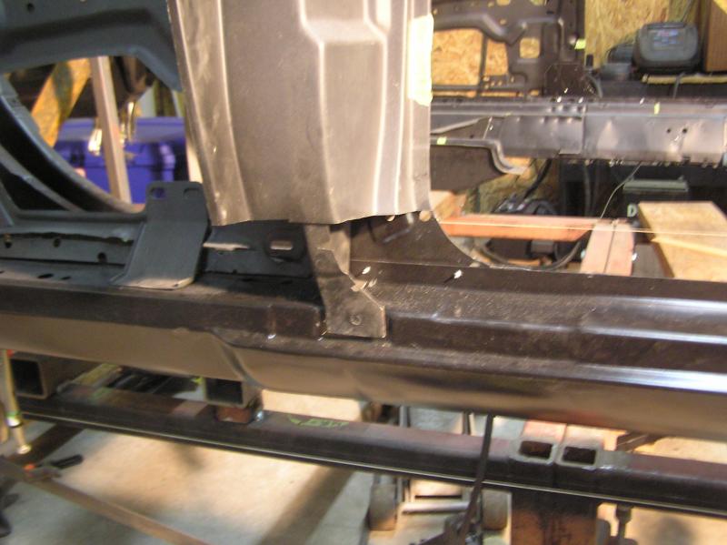

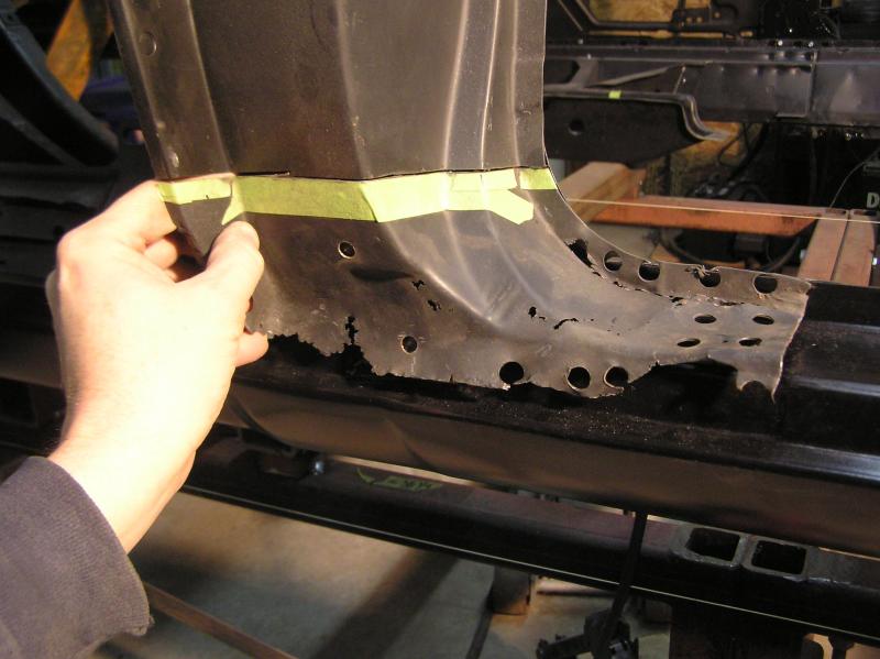

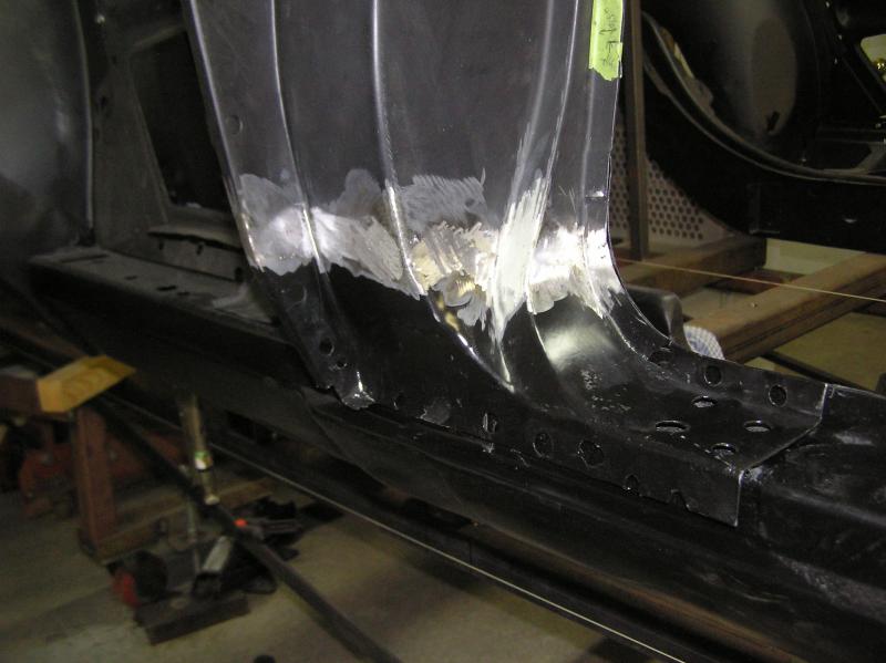

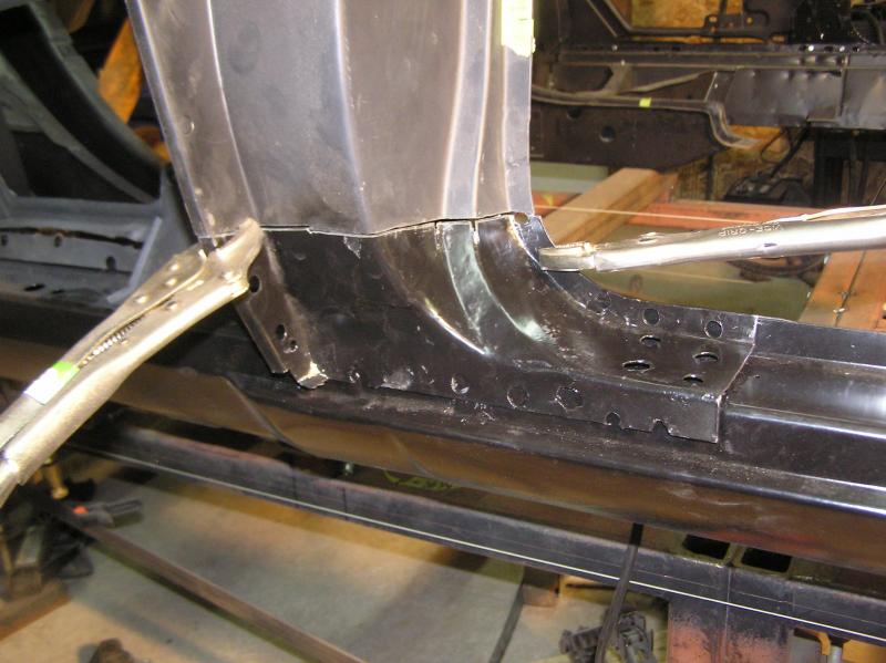

lower lock pillar surgery

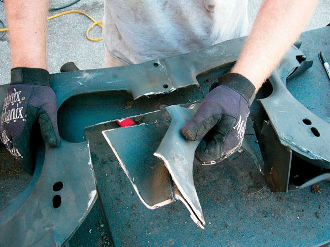

Here is a little New Years Day surgery to show
I sectioned off the bad
And replaced it with a donor piece
here is how it looked after welding and grinding

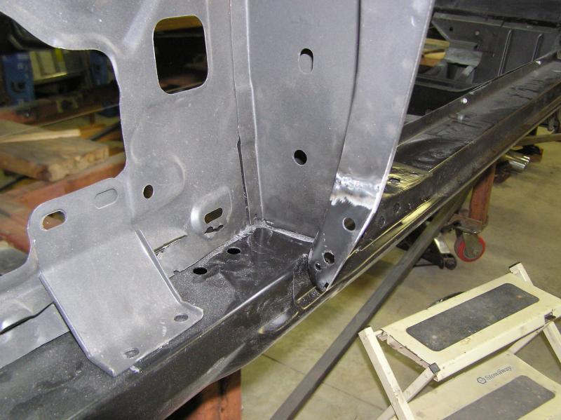

I did run into a bit of a snag!
If you notice the bracket with the 2 holes. This should get welded to the top of the rocker.
PROBLEM is I cant get at it... its on the other side, under the donor piece I JUST WELDED IN! :angryfire::angryfire:
I think the only thing I can do is to add a piece onto the bracket and have it bend to the rear. THEN I can get at it and weld it to the rocker!
Looks good Don, I have to do the same with my rear door lock post on both sides. That bracket makes it a pain, how would you weld that in if you were only replacing and outer rocker? There must be some guys here who have done this?
I think I will simply weld along the seem of the bracket.
It's a LOT easier, and should work just as good.
If I'm understanding what you're asking there - You can't remove the outer rocker with the door pillar in place, which is what's blocking Don's weld.
I replaced the pillars on both sides of my road runner with AMD parts. They went in slick as snot on a doorknob.
I just mentioned it because I've seen others here replace outer rockers without removing them.
I ended up removing that piece, welding it in place then put the door striker panel in and welded it back to that inner piece.
You might could cut a hole or holes with a hole-saw (saving the piece you cut out) where you could get in there to weld them, then weld the hole shut.

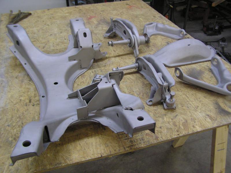

Suspension parts

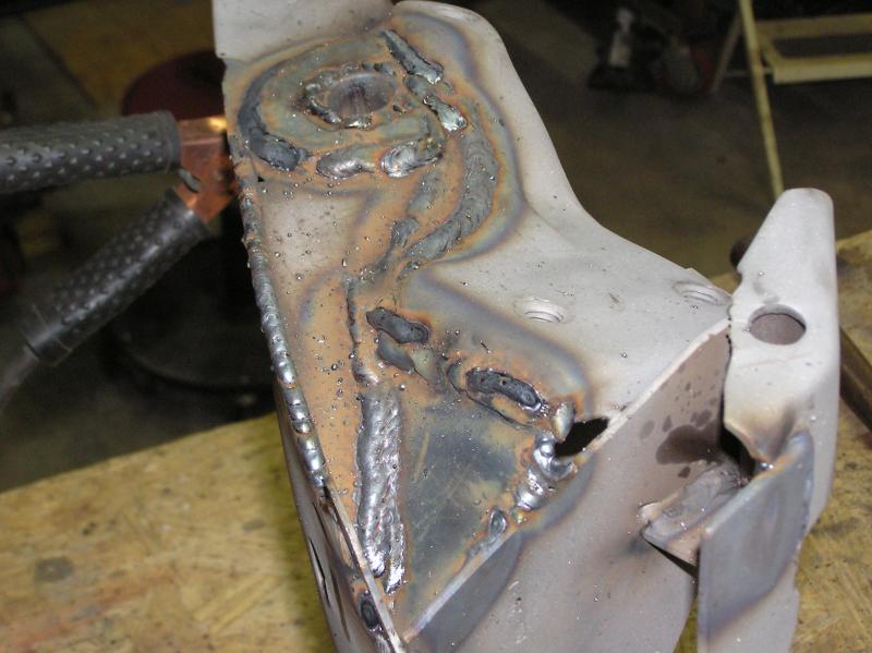

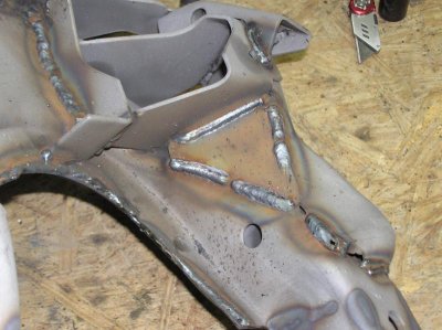

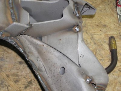

Cleaned up an blasted some more parts

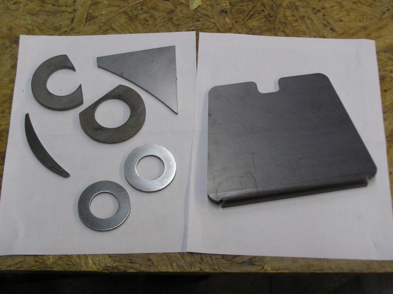

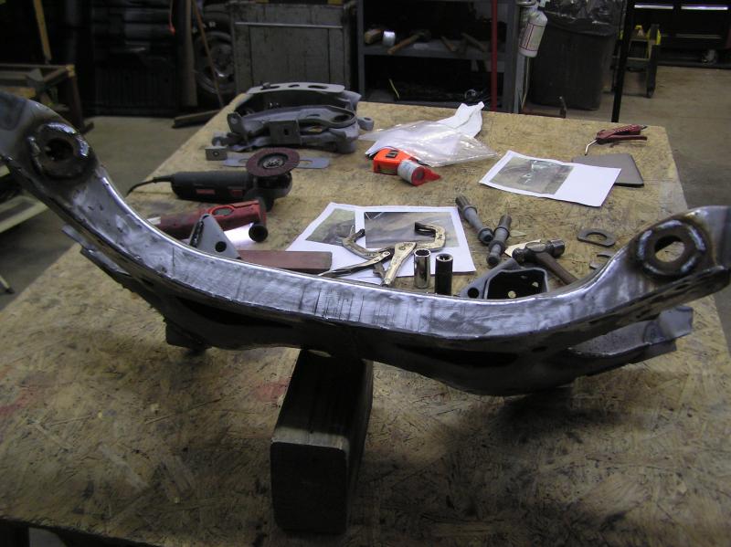

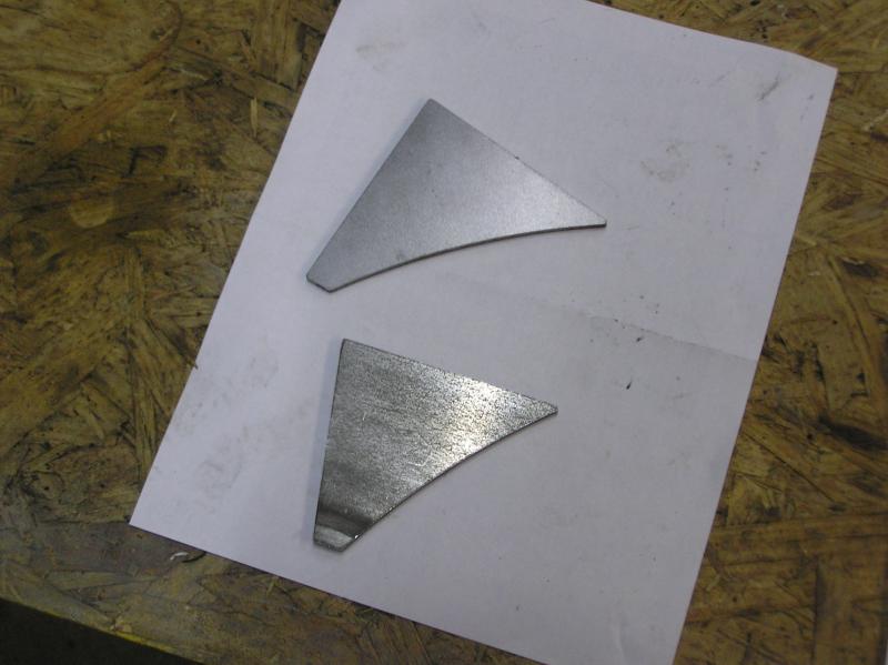

Purchased the Firm Feel reinforcement kit (8 pieces)

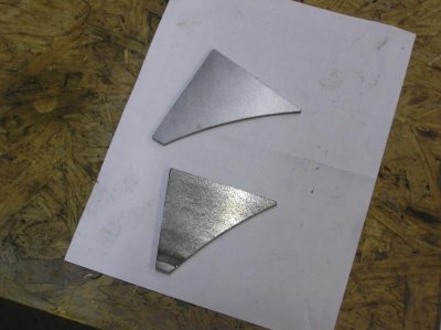

sorry I missed one of the triangles
the lower trangle was not in the above pic

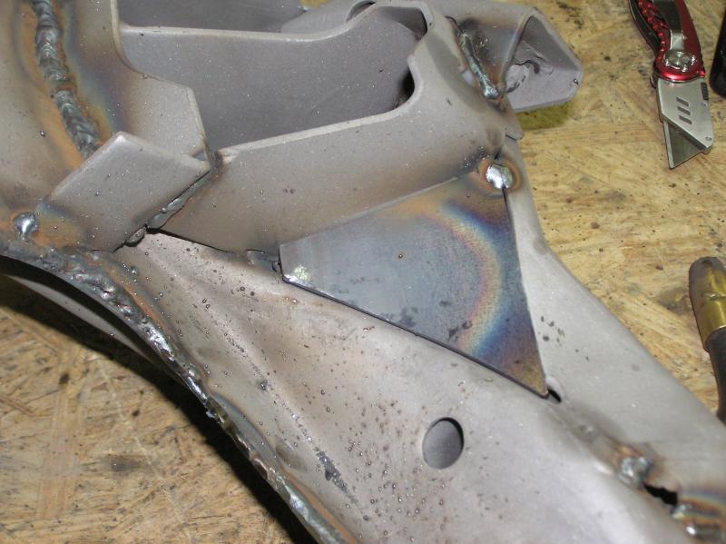

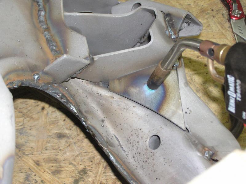

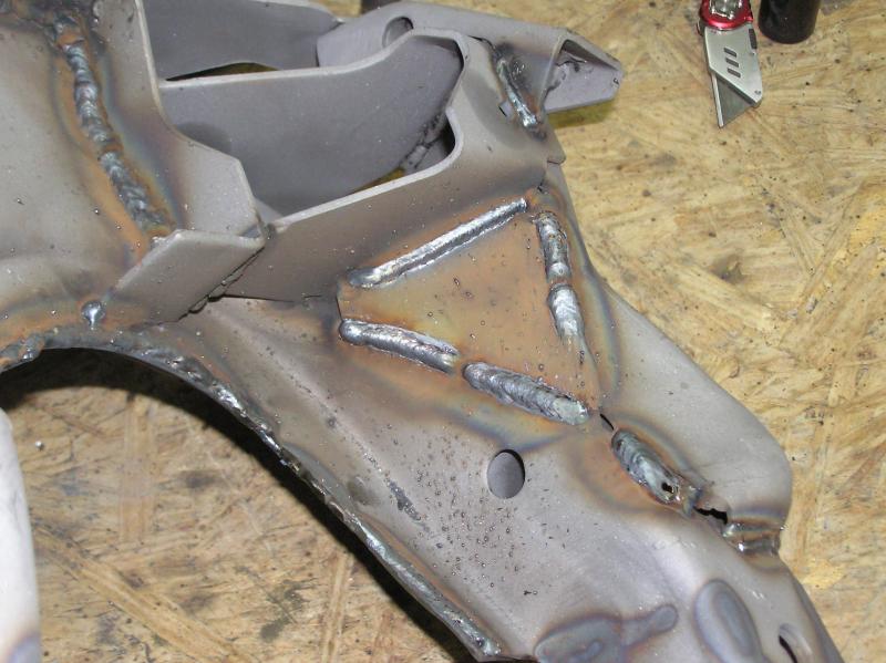

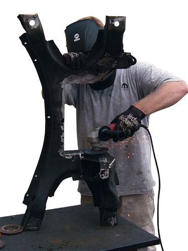

I welded the outer seam all the way around the k-frame
then welded on the pieces from the kit
Here are the large full washers

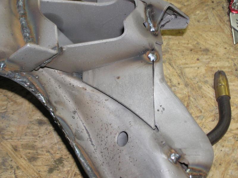

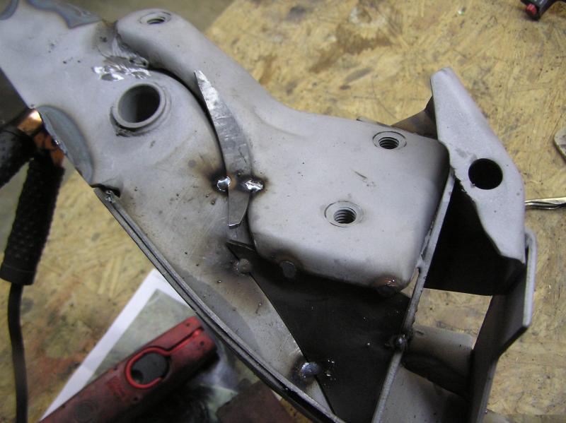

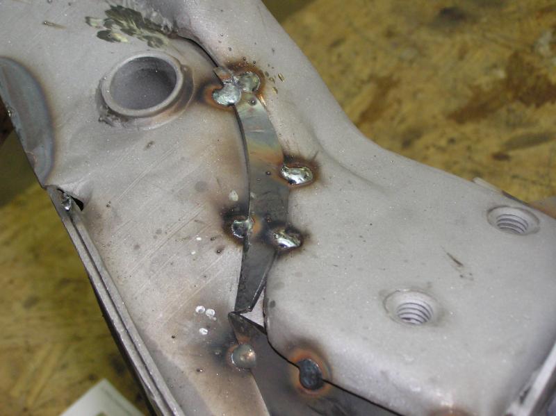

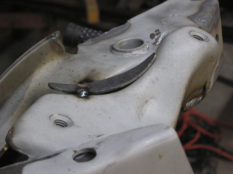

Here I tacked the piece in the corner to hold it
so I cold heat the metal, after which I hammered the middle in,
so the edges would fit better.
Then I welded it
The small sliver piece was done the same way. (No heat was needed)
Sorry, I didn't get any pics of the other pieces as they were welded in
Looks good Don. Are you going to notch out for the oil pan as well?

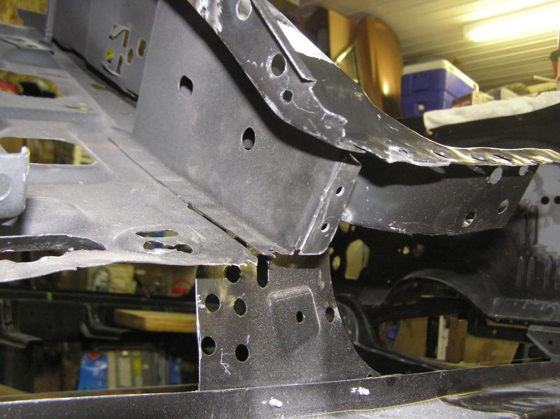

Here are some pics, this is done for the bigger squared racing oil pans.
