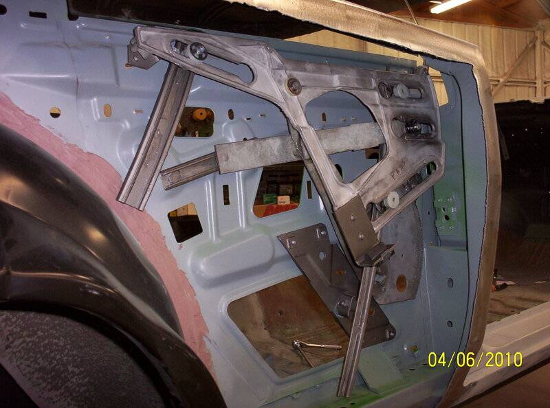

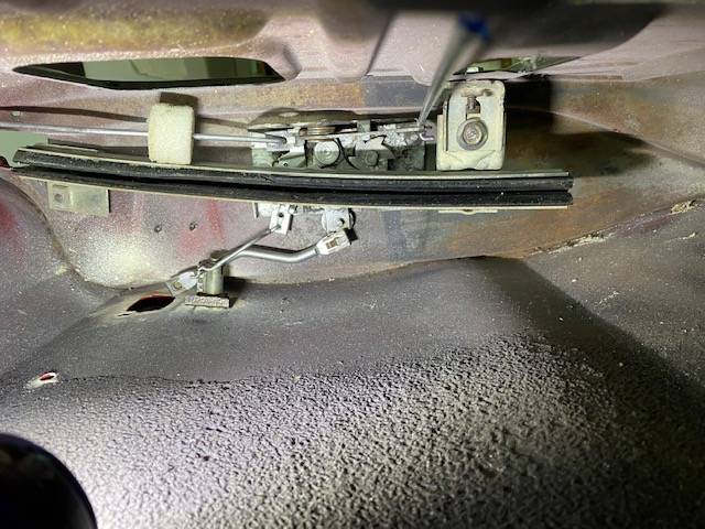

Putting my 69 charger doors back together. Does anyone have a picture with the door skin off so I can view where everything goes. I have the rear quarter windows with the quarter skin cut off so I figured I would ask for any help on the doors. Thanks.

Here is the inside of my door on the 66 coronet. I do not know if yours will be the same for certain, but it shows how the door latch goes in and hooks up to the door handle. I do not yet have the door handle on, but you can see where it goes. The rod you see that looks 3 D coming right at you is what goes to the inside door handle. There is a little guide Clip that goes about where my camera is. The inside door handle is pretty easy to figure. You can see the door lock in lower left and the outside door handle will go just above that. In the front is the Glass guide for the rear part of putting in the glass. You can see that in the post by ZYZZ just above. Hope this helps, Best, B.
I was hoping to see something like this. But of the door.

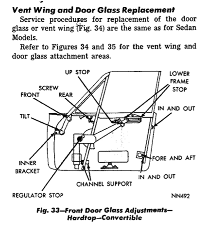

I was able to give you the procedure with "Cartoons".
Thanks. I am sure someone will have one. I have the factory service manual its jut nice to see a real picture as to where everything goes. I took this apart 15 years ago so now is the first time the bag of small parts is spread on the bench. I have photos with the door panels off so it gives a some help.
