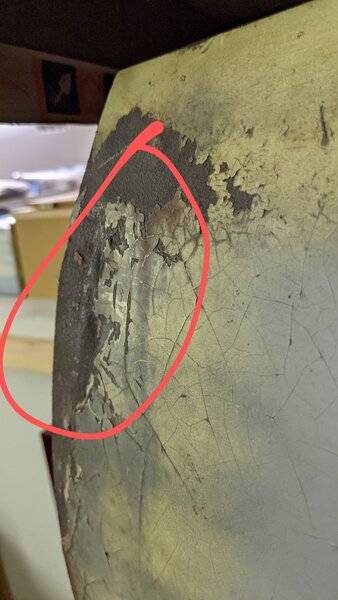

A little background, door must have gotten up against something high, it was caved in along the front edge at the top (hope you can see where I circled).
Ground the skin off and cleaned up the shell, rebuilt the hinges so working with something stable.
Getting ready to take the shell back off and try to bring that leading edge in to alignment with the curve of the fender (which has not been wrecked). Note after this picture I brought the bottom of the shell further in a smidge. Lines up pretty cleanly except the top 8 inches or so. And at the very top, it lines back up well there too.
The gap at it's worst is probably 3/16". Looking at it I feel like I'm going to have to bend the front edge of the shell to a 30 degree angle. I've probably drank a case of beer staring at that shell, and while I can see it's flattened some it just seems too far out of whack. I've tried to apply my martin metal working book learnin' to reversing the damage, but damned if I see it.
I'm probably over thinking it, but figure there are a lot of sharp people on here that have done this before. Any advice (except find another door :rolleyes:) is greatly appreciated.
Let me add, it ain't a show car, but when I can I want to do it right.
Thanks as always!

So all this good discussion made me go back and look closer, and I think whoever slathered all that Bondo on the door originally hammered that leading edge flatter before mudding it. I put a straight edge on the back side and can see it's bulged out some. Passenger door feels perfectly flat in that same area.
I may just need to take the shell and my contour gauge to a good body shop and have them work it back. Getting a little nervous I might make it worse than better.

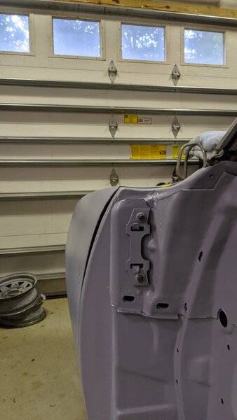

A complete picture with the door closed.
And a picture of the gap on the fender to the shell
From this picture. This is what I see. Im refering to the shell gap. Thats all. Otherwize it looks fine
Pop the skin on a see how it fits.
As long as you have a even gap on the quarter side. And rocker. The front will just require tweeking. So the skin sits nice. I see you have epoxy on it. Thats good.
just remember not to have the shell out to far. Prior to skinning. It should be inset of the fender. You have the latch in the shell?
Yeah that's where it is positioned now, just inset from fender top to bottom. And good point on the latch, I will put the latch back on the door and car and get it setup before going any further.

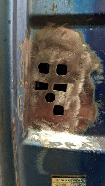

This car is a freaking labor of love. This is what I had to do just to get to this point. What ever hit it to destroy the original door must have yanked the damn thing open. Still haven't figured out how the rest of the car can be so straight but have this kind of damage.

Thanks again for all the help, much appreciated. I will get the latch setup and get some better pictures of the gaps.
Not everyone wanted Maaco to touch there car. So some will try to make it work themselves. Its alot of fun to do. Sometimes difficult. But patience is key. Enjoy your project.
