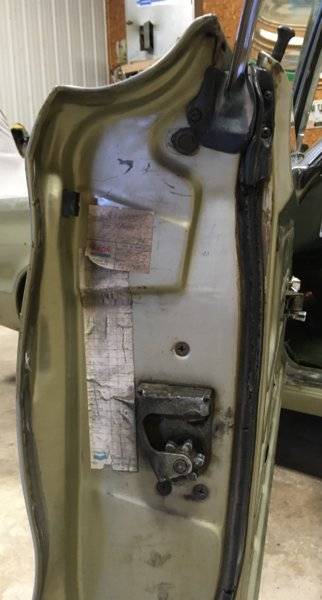

Does anybody have tips on how to properly adjust door windows, or know where some guidelines are published?

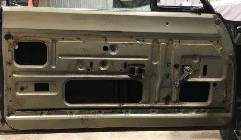

First, how do I set the window up stop and down stop? It’s going too far in both directions.

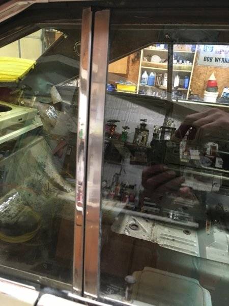

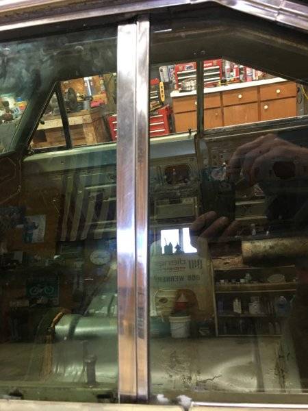

Second, I need to address this issue (see photos), which may be front or rear window adjustment. First one is bad, second one is good.

The gap between the back glass and the door can be adjusted with the back glass. In and out at the top adjustment can be found at the very bottom of the glass tracks.

2 Questions: How does the door downstop adjustment work? Where is the door upstop adjusment?
Thanks! This is helpful.
On my old '62, there is a cam that stops the regulator on the down position. You loosen the lock nut and turn the screw left or right to change the position of the cam to where it makes contact with the regulator.
The up stop is just a "L" bracket in a slot that the glass frame hits against. Loosen the bolt and slide it up or down.
