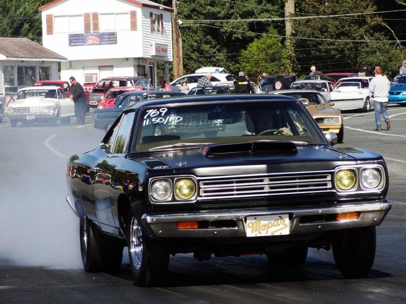

Street tire is an MT ET street 16.5X31
Track tire is a 10.5w X 29.5.They both hook but the slick is faster.

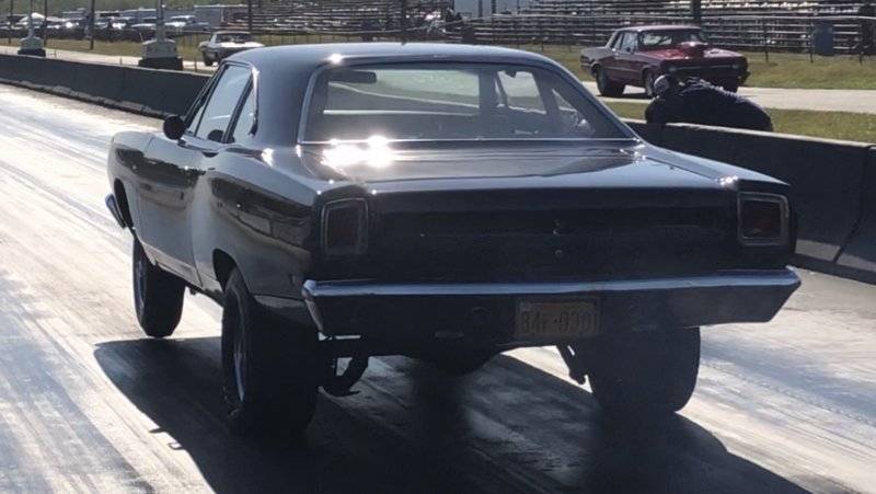

I run M & H 275-60-15 bias ply street tires on my '69 Road Runner. Runs 11.0's and I drive it all over the place. I do not drive in the rain, but the hook is good. I'm not a guy that does a lot of burnouts on the street. Driving it somewhat normally gets me about 4000 miles per pair. I've had at least four pair. I couldn't agree more with your thoughts on the Nitto's. No matter how good they work, I couldn't put them on my muscle car. I ran the M & H's because of the name. I came to love them for the way they work. With a pair of 29.5-9-15 MT ET Drag slicks, I see virtually no difference in 60 foot times. 1.55-1.60.
