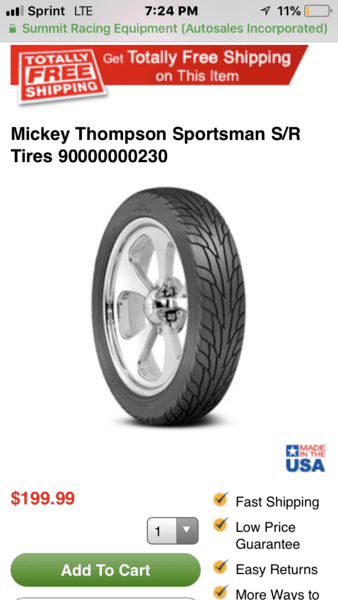

If you are looking for taller than 26" ,that's where things get tougher. Australians have access to a 185x80-15 that to the best of my knowledge is not available in the U.S. That leaves Mickey Thompson SR 28" radials as about the only choice left, and I believe they are over $200 each.

Thanks for all the replies, I went with the MT Sportsman 26x7.5x15 4 ply tire. I could have gone with the 28 inch tall tall instead of the 26 inch but they fit great and drive well. All good.
