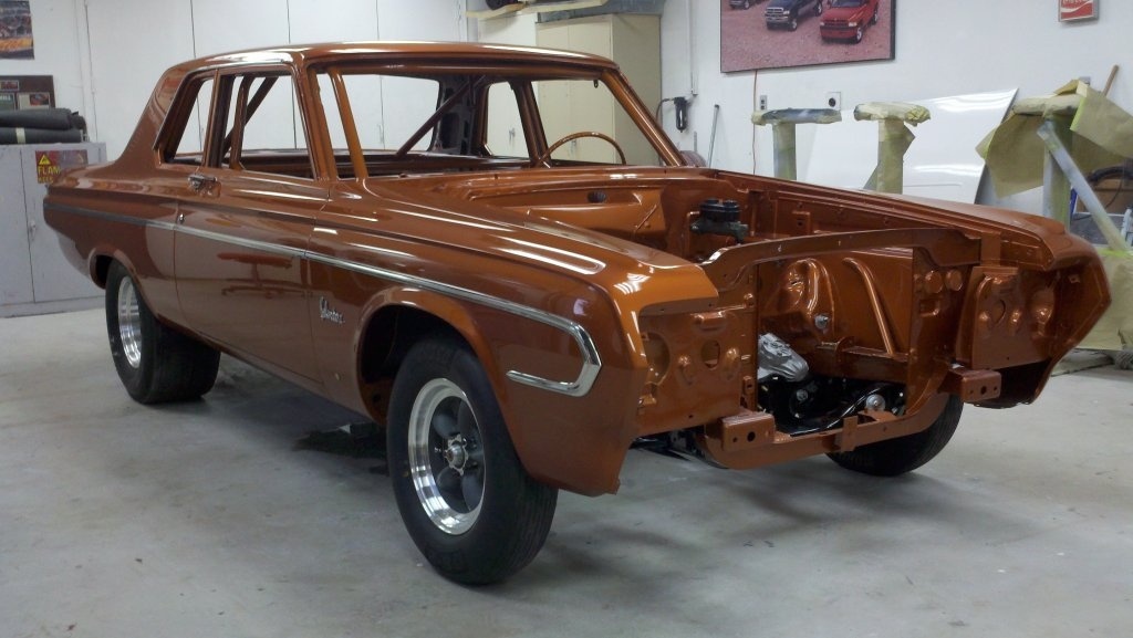

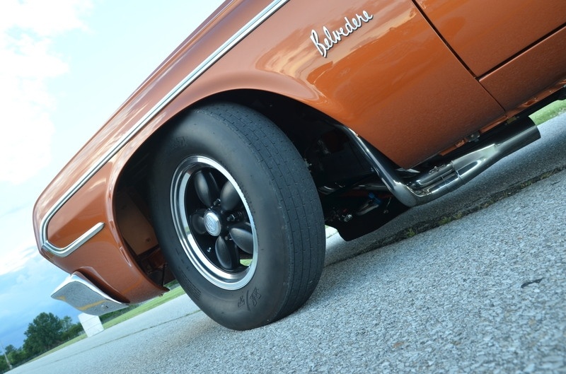

Hey everyone merry Christmas. I'm looking to get a set of weld black skinnies for the front but not sure what the correct off set is. It's a 69 charger with QA1 upper and lower control arms and strange disc brakes. I just don't want the tires sunk in the fender well to much. Any help or pictures of what your using would be great. Thanks
Less backspace equals the further out they will be. You can't add much to a 3.5-4" wheel anyway. Most are around 1.750"-2.125". Here are 15x4 American 200S 2.00" back space, 28.5 M/T tires.

Now that looks sweet! That's what I'm looking for. Thanks for the picture. Nice ride.
Yeah,what he said. You will find that most rims 4'' wide will have a 1.75 backspace.
The less backspace, the better on old mopars. Gotta fill those wheel-wells.
