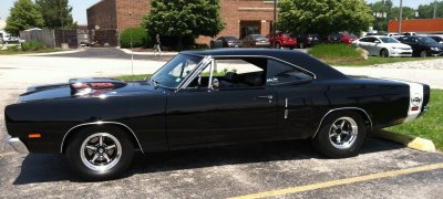

Here's the 15x10x5.5 wheels with 295 tires on my 69 Bee
Hey guys thanks for the replys I really appreciate it. The bee looks sweet thanks for the pics that helps out a bunch.
On my Bee, with the 5.5 backspacing, as you can see, the wheels/tires are not sticking out of the fender wells. A smaller backspacking I'm sure would push the wheel out of the wheel well.
