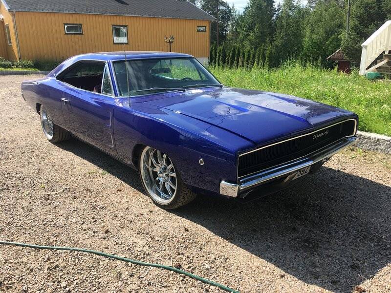

Picture of picking up the car in Norway May 2019. It was original Red paint and Red interior. 318 original engine but this was swapped with a 440.
I used the whole summer 2020 and got it painted, also with new rims (Ridler)
quite happy with the look but I want 12" rear and 10" front

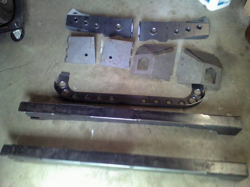

I also want to strengthen the chassis with a kit from AMD.
anyone done this and have recommendations?

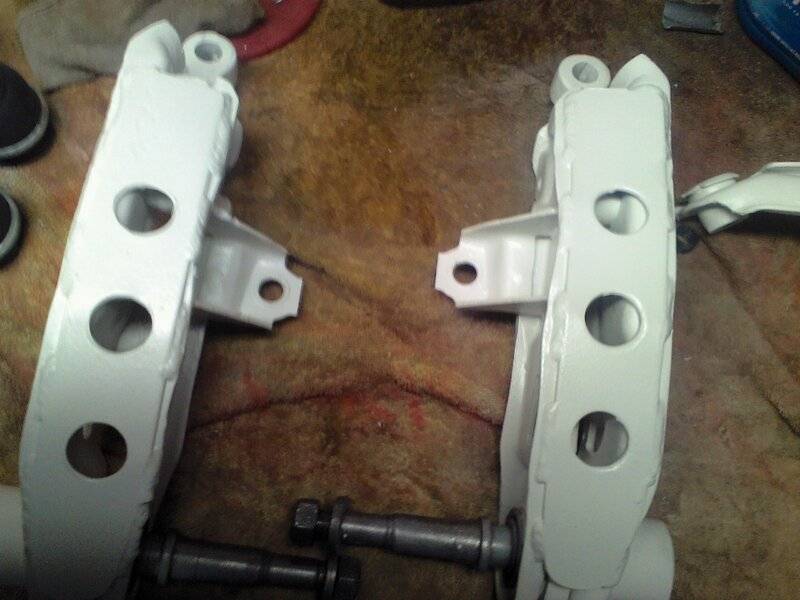

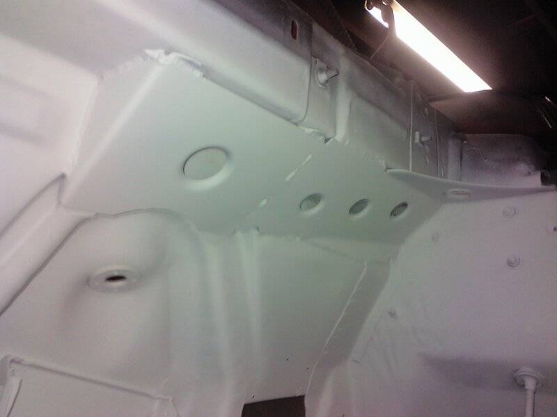

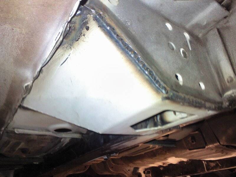

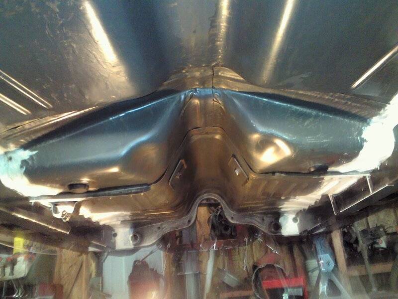

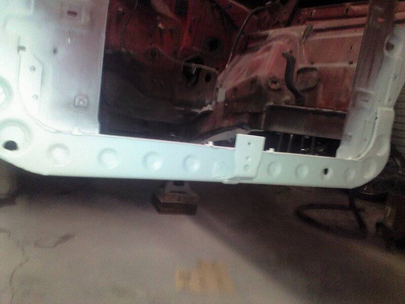

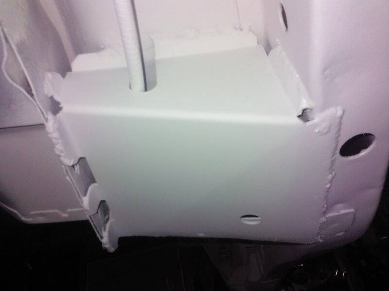

Welcome! My advise would be to go with the US Car Tools Chassis Stiffening kit instead of the AMD kit. I used the USCT kit (subframe connectors, torque boxes, lower radiator brace, and inner fender support) and and it was beautifully crafted and actually fun to weld in. fit like a dream. I cant speak for the AMD kit, but there's no way it could be better than that USCT parts in my opinion. I posted a link to the level 3 kit with minitub below, but you should not have to tub and relocate rear springs to fit a 12" wheel with the correct backspacing. You will likely have to "dehump" to outer wheelhouse though.

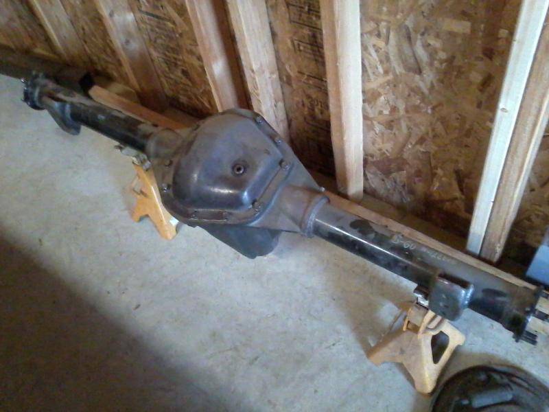

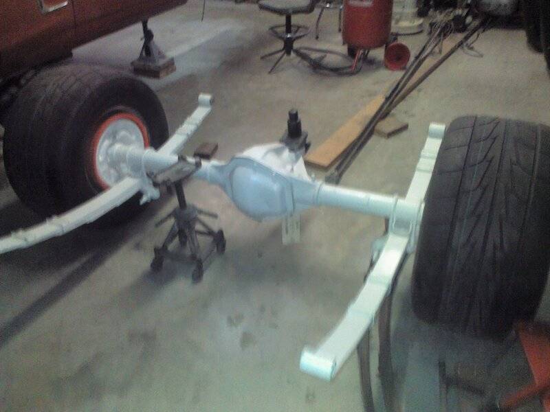

I have done the "dehump" in outer wheelhose, but I may want a stronger rear end, but I may drive with the original 8 3/4 in the beginning.

sweet charger !...I recommend any chassis stiffeners for our cars...I pieced mine together off ebay from abandoned projects and sales...I went to the STRANGE factory in Chitcago and bought a housing set up to 70 B Body specs...I then installed a 30 spline 4.10 Trac-Lock from a Cummins pick up. Ithen ordered a set of 30 spline 8.75 axles for a 70 B bodyI have around 1400.00 invested in the rear end with rebuid kit.I could of went with the 35 spline set up but price was a factor and I figured if that rear could handle the cummins with a skid steer n simon forms + drums of tools n string line pins on a trailer behind it it would work great for my plans

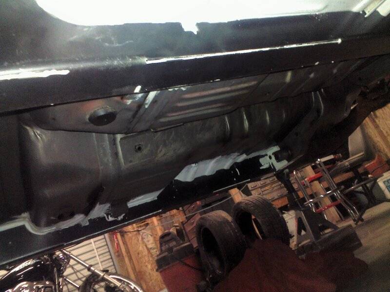

Do yourself a favor and look closely at these "chassis stiffening kits" and you may ask ....wheres the 1500.00 dollars...not to mention shipping to Norway. These parts are easily made with some basic metal working knowledge and tools and are what racers have been doing with these cars for 40-50 years. The 8 3/4 rear will be fine with some upgrades.

I may also want to swap the rear end to a dana 60 when I'm at it. Is strange the correct alternative? I want a "bolt on" kit
You can get a strange S60 unit, that's what I have as well, it won't be bolt on when converting the rear to 4 link though. Another option is a currie unit or moser units

US car tool makes a complete kit, I am running their setup minus the subframe connectors which I had already installed.

I'm going to chime in here regarding a statement earlier about US Cartool stuff falling right into place. Thar is far from the truth. I've used 4 sets of their torque boxes and will continue to. They fit ok, but do need metal added in some areas and metal removed in others to get perfect fitment before welding.
The inner fender braces are pretty good, only requiring slight mods for nice fitment. You will also have to modify your inner splash shields if using these braces.
Their frame connectors are another story altogether. You will have to deal with modifying for e-brake, regular brake, and fuel lines. As well as a lot of grinding to get nice fitment to your floorplans. I used them on my last car, and while they look nice now, I will never buy them again. I will go back to making my own connectors out of rectangle tubing and a few plates.

Is the AMD frame connectors maybe better than the US Cartools?

Another headscratcher will be the dana 60 upgrade. The lowest gear ratio for them is 3.54. The hellcat with A8 have 2.62 original. I am afraid that the 3.54 will not fit the transmission so well and the gears will be too short. (a lot of shifting)
So I may want to run with my standard 2.76 8 3/4 to begin with.
Gerst !!!!!!! Dr Diff has a 3.23 gear for a d60, he is also a distributor for strange

I bought a Strange S60 from Dr. Diff with 3.23's. Also wasn't aware that AMD made frame connectors?
