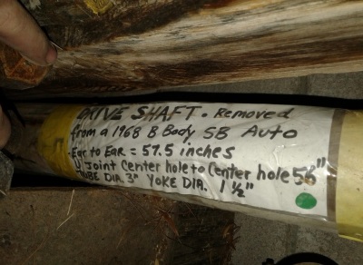

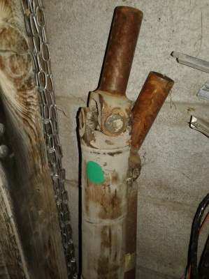

I have a driveshaft removed from a 1968 Coronet 318 auto 904 trans. 8-3/4 2.76 open. It's to my best knowledge that all 68 B Body cars came with an 8-3/4 rear end. If you're still looking send me a PM and I can go more into detail.

Everyone is making this way too complicated. He said he is CONVERTING to a 727. That eliminates all original 904 application driveshafts from the picture. They are too long, as the above picture even confirms. The service manual ( remember them ) and the parts book show lenght for each engine/trans applications. I told him in a PM the correct lenght, 52", there is no debate. Only option is what U joint size choice to make the swap easier, in his case the 'small' 7260 would do it. Stock applications for 68 came both sizes of joints and yoke for the 727, depends on engine.
