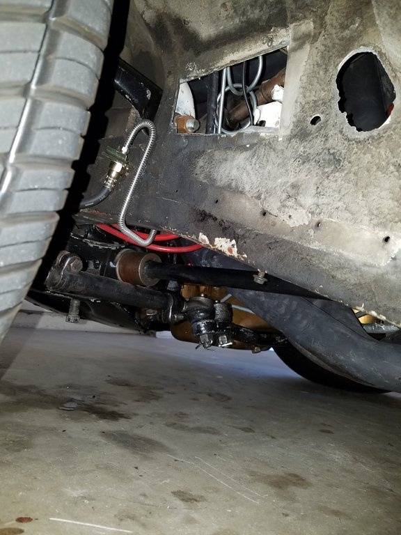

If it's the one I think it is, there are 3 or 4 small (3/16 or 1/4" maybe) holes in the bottom of the frame rail behind the left front suspension, where the shield attatches with washered screws...mines not on there at the moment...look close I have one screw in right now. There's a few other shields missing but you can see the screw holes for those too

The frame rail splash shields located between the control arm and firewall are attached using spring clips, no screws. The splash shield that are attached with screws are located in front of the control arms below the battery tray and washer bottle. The shields will only fit in one position, so it is not like you can position them in the wrong spot unless you start to modify them.
