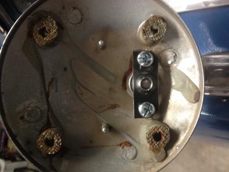

A number of years ago I picked up this factory drivers side mirror for the grand total of $2. Yep, $2. It was driver quality with plenty of patina but the chrome was solid. Only issue was it had some serious flop going on, we're talkin Al Gore before the little blue pill. So the plan is to de-flop it. Any ideas?

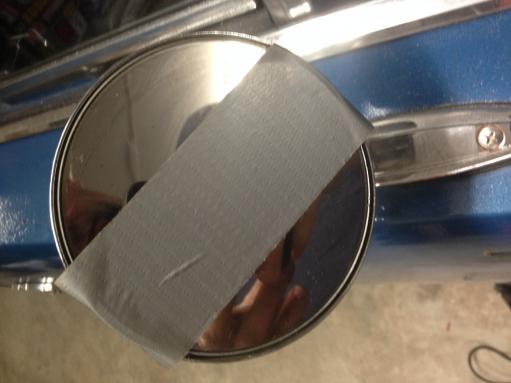

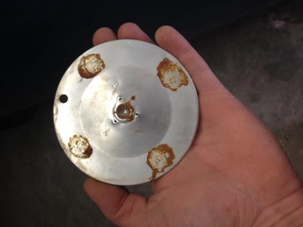

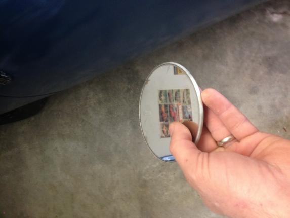

glass came off nice and easy. I used double stick tape to stick a small piece of angle iron onto the glass, let it set for a while, then yanked with a pair of pliers. Came right off in one piece -looks like it was just glued on in 4 places. Should be easy enough to reglue...

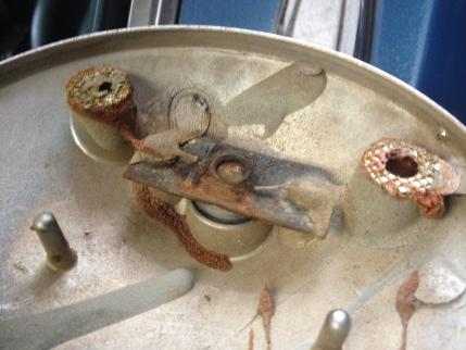

Are those screws under what looks like glue? If so, There are several ways to create more friction between the ball and plate. Dimpling the plate a bit would work, or maybe some type of thin/pliable material to tighten the ball to plate. You could also create some "tooth to the inside of the plate, similar to knurling.

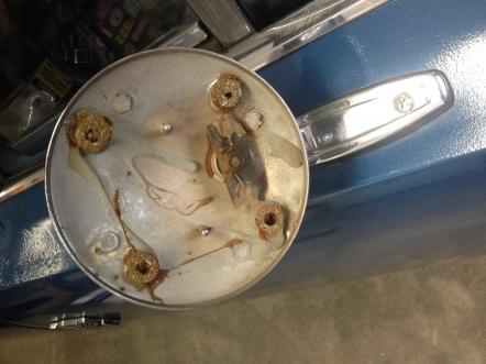

Nah, looks like rivets. I sure wish it were screws, like the rear view mirror.
Grind the rivets off, then drill and tap the pedestals that remain with something like a 10-32 machine thread. Once you get that center plate off, you can either torque it a little to create more friction, or grind the pedestals down a little bit to get the extra interference.
Sounds like a plan. One worry, what's the housing made of? I hear horror stories about tapping pot metal, not sure if that's what this is.
It's pot metal. I've had success drilling and tapping it in the past. I would recommend using some Loctite on the screws so that it holds without over tightening it.
I tapped the mounting screws on the tail extensions of the 67 Coronet, they are pot metal. It worked out great.

Thanks a million for this post, I've got a flip flopper myself that's been pissing me off something fierce. Now that you've shown me how to get it apart I'm on it.... I think dsd has the right idea.
Might not hurt to hit them with a blaster with coarse media for more friction.
Thanks fellas, for the help. I'll take care of those rivets and drill and tap for some screws. I was thinking of keeping it simple and just hitting both surfaces with some coarse sandpaper and perhaps tweaking the little plate for some more bite.

Ok, ground down the rivets, drilled some holes with a #29 drill and tapped the holes for 8-32 screws I had laying around. I then roughed up the ball and socket with some 80 grit, bent the socket plate for a little more leverage and tested it - perfect! So I screwed it all together with some blue loctite.
Didn't take a shot of it, but I used some 3M marine adhesive to glue the glass back on. Before that, I removed the old adhesive and roughed up the surface with a dremel and mini wire wheel.
