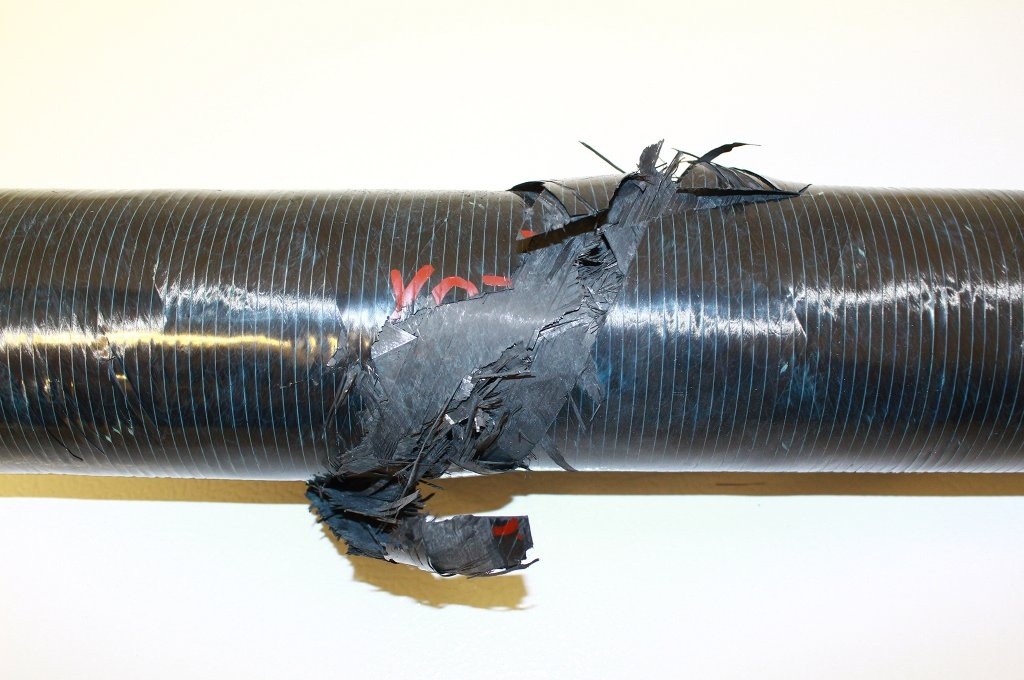

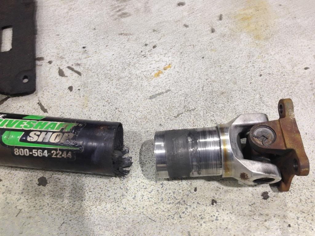

I would be concerned about the bonding process to the yoke myself for a mild- hi performance daily. Not sure what happened in thes picks but it is ugly!!!!:eek:
View attachment 394651 View attachment 394652
Tore like it was a big toilet paper tube!! hahaha I was thinking due to differences in stiffness there may be a slightly 'softer' launch as well...even if the flex is overcome in less than a second, it's still there? Of course, this is the space age lol they'll probably come up with a solution...
