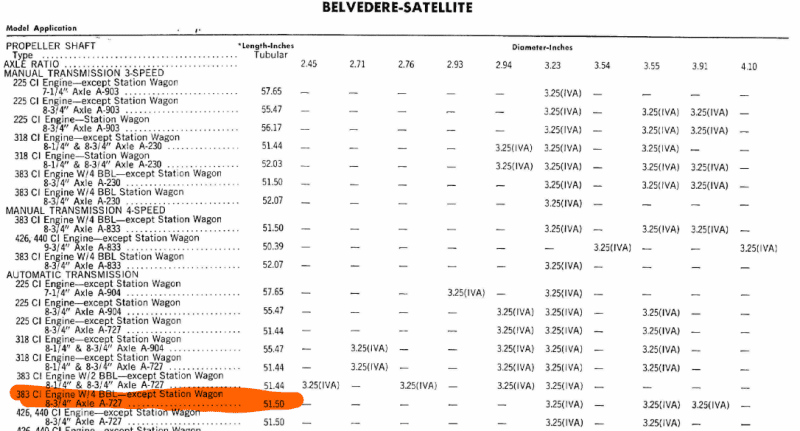

You have a Plymouth driveshaft in your dodge.
Ii would be surprised if a longer shaft fixes your problem. How badly worn is the bushing? Is the vibration at all speeds?
Oh i will change the bushing to, well from 50 and up i would say, not a huge vibration but you can feel it,
How do you know? =O
This is how - from 70 Plymouth FSM. If you don't have service manual, download from free at mymopar.com.
