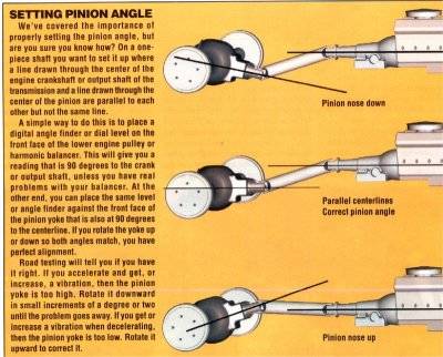

Based on what you shared. My rear angle is wrong. Not, my front. Because it’s too straight in line with driveshaft at the rear ? Adjusting the rear will make it, right ? What has to be done to adjust it, rotate the rear axle toward the front of the car after you loosen the shackles ? To point the rear yoke downward to get proper angles ?
My rear yoke is in a straight line with drive shaft, pointing up toward tail shaft. The rear needs pointed down and parallel with tail shaft. That’s, my problem.
I’ve found it’s very common to have the angle wrong, I’ve measured enough Mopars that I usually have keep 2 degree shim kit on the shelf...
Only time I’ve needed any other shim was when things are modified...
Just support the car on the frame, loosen the U bolts on both sides of the axle & slip the shims in with the fat end of the wedge to the rear.... Tighten the u bolts & take it for a test drive
If the pinion is straight with the driveshaft at the rear, you need to shim the perches as R/T says. The U joint will wear excessively if it is truly straight. U joints NEED angularity. The straight rear angle can cause a vibration. Also Mopars are NOT supposed to squat during acceleration, they should rise. The center diagram in moparsaver's post is what you want. 2-3* nose down for a moderate power application, 4* down for high power good traction.
They sell spring perch shims in 2* 4* 6* When I changed leaf springs on my 65 I had to go with 4* down to make a vibration at 60 mph go away.

If you have factory mounts and the perches have not been cut off the housing and repositioned, you have all the ‘correct’ angles. I used to mess with lowered trucks and we had to shim the rears on leaf spring trucks for sure. Usually we went for 5* pinion down for the angle. Leaf spring rears try to point up under hard acceleration or launch.
