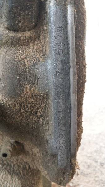

Look above the trans pan for a stamped #, like this...it will tell you year and what it was installed into.

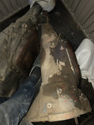

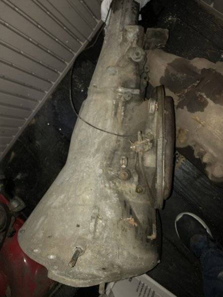

K I got two transmission and found the identification numbers. I’m pretty sure one is from 318 that was in car and the other is a 727 but not sure so here’s pics(bad ones due to dark) and the numbers.
one is J2 01543 3820170

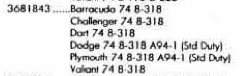

others is PK3681843 4455 5210

I'm not sure on the 1st one, but the PK marked one was in these...
Does the other one have a shorter tail housing?
904 is basically a small block (Or slant six) trans. A 727 can be a Big block or small block trans. The bolt pattern where the trans bolts to the back of the block is different for /6, small blocks, and big blocks.
If you KNOW that one is the small block trans from your 318, check your other trans to see if it has a different bolt pattern, and starter location.
There are also differences in the trans pan shape. A little research on line can tell you which is which.
