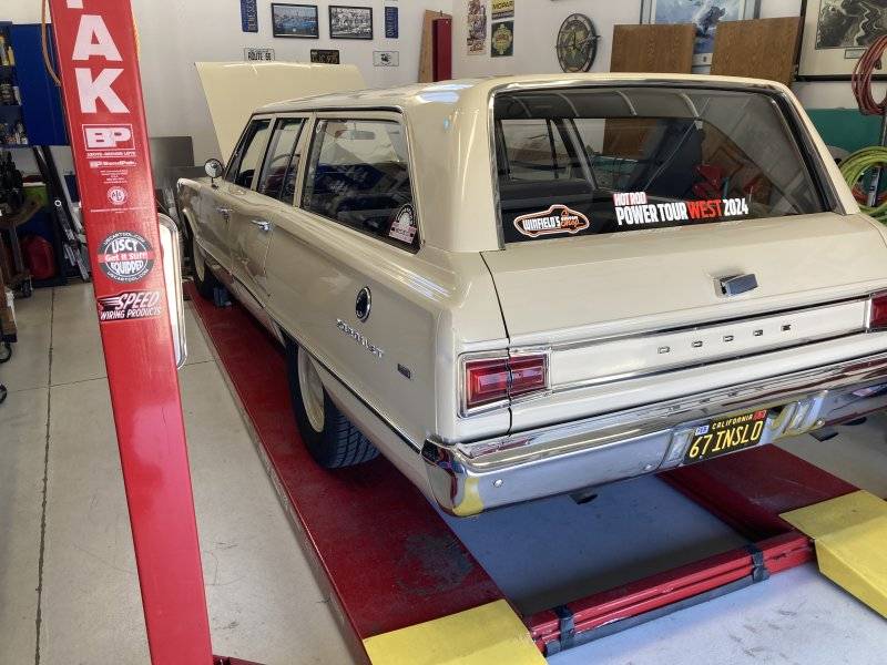

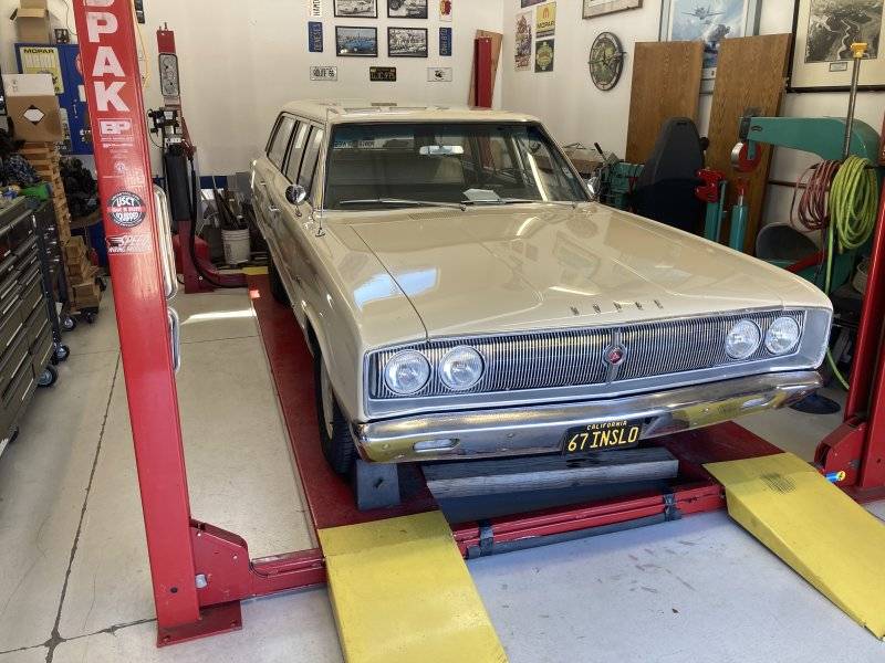

Generally on mine, when pulling forward, I just eyeball it. I'll get to the ramps, get out to see if I need to move right or left, make the adjustment, get out and look again. From there I'll look out to see the runway and watch the spacing. When I clear the ramps, shut it off and move it forward, chock the tires and make sure the I clear my garage door on the backside. I had a friend spot this time since I wanted to back it on and have better access to the front end for the work I'm doing there.
