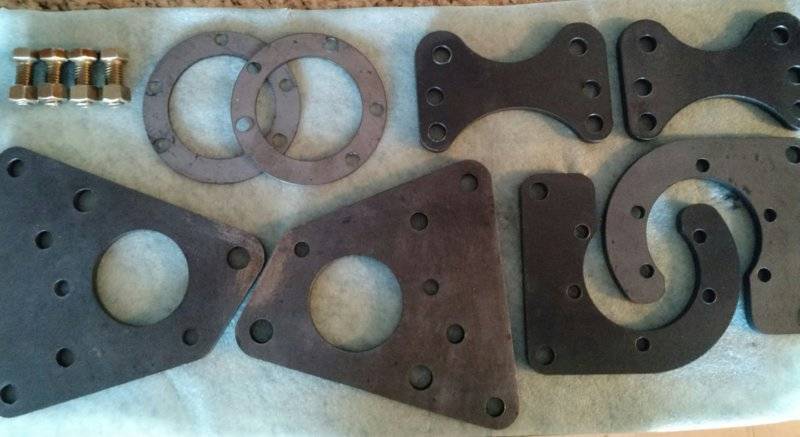

I am getting a set of his brackets. I've also already purchased the front and rear calipers for the 13.2 front and 11.8 rears. I'lll let everyone know what it ends up costing me for the complete package.

Don't forget to take half a mm off the inside of the rotor hubs and grab some .625 knurl wheel studs from moser
And you'll need a master cylinder. The one DR diff sells is a great deal at 95 bucks
