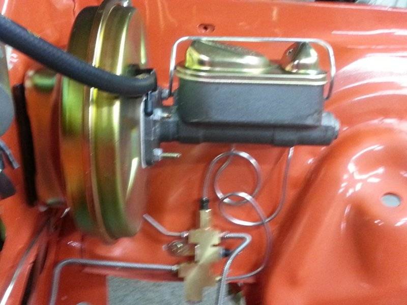

"looking a bit on the cool side". That's easy for me, MOPAR. You can hide the valve if need be
That's a nice neat setup. I ended up biting the bullet and I got the Wilwood master cylinder on a new booster with a new valve. I liked the fact the whole thing was black. A living in ireland it's hard to keep chrome or zinc finish looking good after a few months due to the wet weather. All I have to do now is wait till the end of August for my parts to arrive and I'll post up a few pictures of the work and my verdict on if I made a good decision or not.
