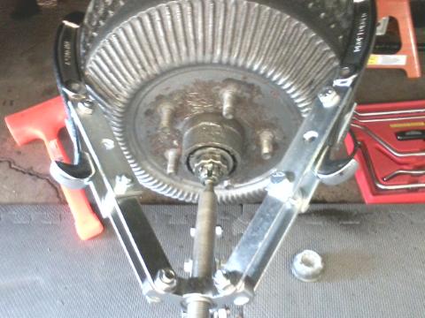

I start with the pass side front. I try to get the drum off, but it wont budge. I back the adjuster off as far as it will go, and it still wont move. I smack it with a BFH (4# dead blow), no dice. I heat the face of the drum up with a propane torch for a minute or so, still stuck. Buddy of mine says go to Harbor and get a 3-jaw puller. The biggest one they have is 8". I buy it anyway and extend it to 12" with some "engineering" lol
I put a 1/2" socket wrench on it and start a-crankin'. Puller gets real tight and I smack it with the dead blow a few times and the damn thing still wont come off!! @%^&$%^*!!!!

I'm not sure if your photo is clear,but... Why is the puller on the drum with the nut still on the spindle ?
Take that nut and outer bearing out first Mario.

I think the drum is swedged on from the factory making it a one piece hub! You can try and grind the studs at the drum if you really need to change it! Better yet just take the nut off and pull it as a unit! I noticed in the pic. the nut is still on! Hope this helps!

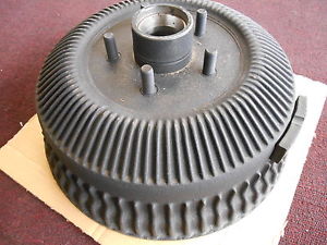

Should look like this Marpar
