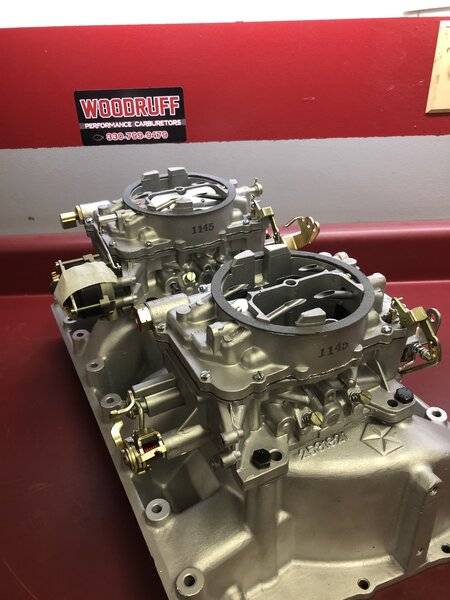

I have dual Carter AFB's on my 66 Hemi and it's a hard starting beast. The front is 4139s and rear is a 4140s. I don't see any choke on them. Are they original? I would like to send them out for a rebuild. Any suggestions?
The numbers appear to be correct. As for original, you'd have to check the dates.
4139 and 4140 are correct for 66 426 Hemi. Are there holes in the air horn for a choke shaft and butterfly?
They're very easy and simple to rebuild yourself. Otherwise, Scott Smith at Harms is a great guy to work with and he does great work.

Car build date is on fender tag in lower left corner.

Scott at Harms Automotive. Yes I think they are correct for 66-67 Hemi's.
