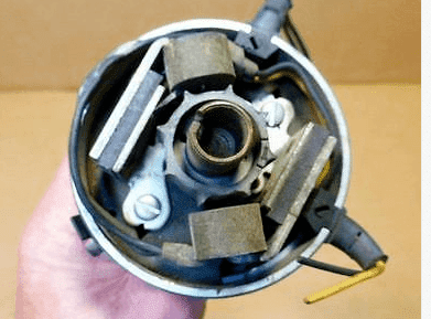

Never saw one of these. If you wanted to run two ignition systems for dual plug heads would it work? Thought that someone made this perhaps?
http://www.ebay.com/itm/Mopar-41457...e=STRK:MEBIDX:IT&_trksid=p2055119.m1438.l2649

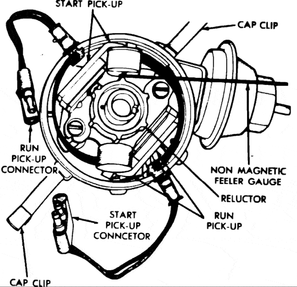

Not sure, but if it is like the distributor in my 87 truck, the second pickup is for the starting circuit only.
start/run. dual plug would need provisions for another set of plug wires; basically two distributors.
Post sounds dumb , no way to run two sets of wires.

Memory fade here, but weren't those used on the "Lean Burn" systems of the late '70's?
i think your right. i always wondered about using one of those distributors with a crank trigger. the shaft can be used for a locked out distributor with a single pick-up.

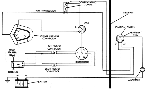

It's in fact for the lean burn cars. One of the pickups is just for the starting circuit and the other one for the run circuit which by a relay makes the selection of which pick up will be working depending of the stage of the ign system, start or run. I have the diagram, somewhere.
The pickup for the starting stage sets the spark a bit advanced as far I recall for a faster start up.
I do believe it retards timing to aid in starting. Think about it why would you want to add more advance to an engine that has already been advanced to just under the point of detonation. It may start cold but advancing hot engine time has not worked well.
