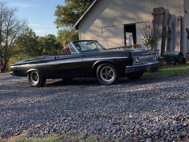

I'm working on an old, Chrysler dual point distributor. It's been in our '64 Fury Convertible street car for some time. I want to replace the points, condenser, cap, and rotor. I've never worked with points in the past. Can you tell me what the gap should be? I've heard a number of different responses. This is in a 440. Photo cause winter sux!
