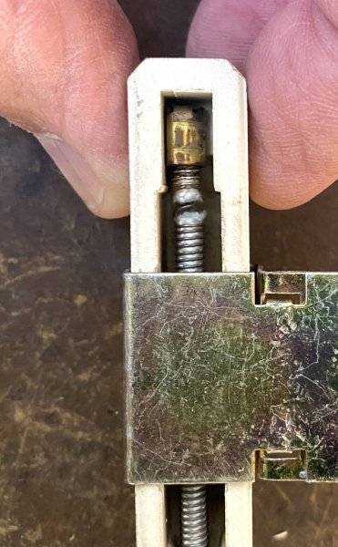

Here is one way will not check the capacity though more of a pass fail. Use a analogue meter!
				How To Check a Condenser on a Points Ignition
I get asked this all the time.  I have a condenser tester but I do it daily. This will work for you. This is for an analog meter but a digital works--you will see the voltage spike.  Hope this helps  1.) Remove the condenser from the engine (or...
