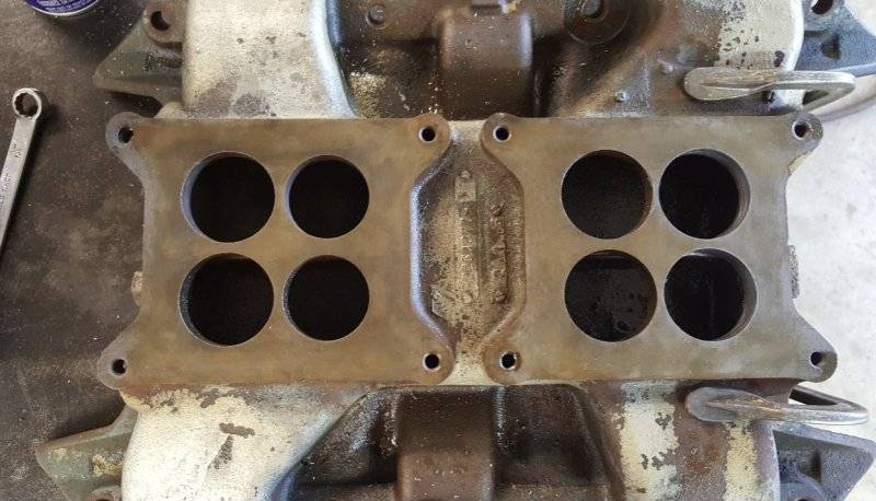

It will work but unless you use the original style carbs on it you'll have to have the secondaries opened up for the newer aftermarket carbs. There were some adapter plates available. I found a 1 11/16" reamer on ebay, a used old discarded carb base for a guide and a 1/2 drill and opened mine.
You can see the set of holes on the left have the smaller secondaries. The ones on the right I have opened up.

If you do use it, there is no need to grind anything on the manifold, as 625 AFB carbs [ Carter or Edel ] would be best on a 383 engine, & nothing needs to be 'opened up'.
This intake probably uses the 'narrow' AFB mounting pattern, but both Carter & Edel AFBs have the wide, dual pattern base so that the narrow pattern can easily be drilled.

The secondary butterflies are larger on the aftermarket carbs. They won't fit through the openings on the older manifolds.

The secondary butterflies are NOT larger on Edel 625 AFB carbs.
Same size as Carter 625, 1 11/16"
