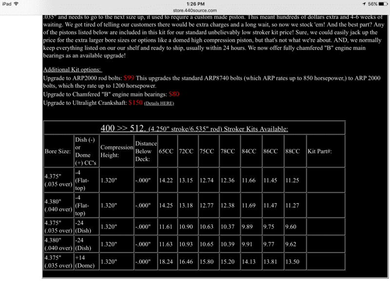

Rod length 6.535 piston-24 dish 0 deck and 1.320 compression height.
Well that explains it, then. Any material removed from the deck is going to result in the piston being above deck. You could have just used a thicker gasket as Stanton did, eliminating the fly cut and re balancing. Then you can dial in your quench distance/clearance with the gasket thickness. If it's .010 above, just use a gasket around .040. I'm building a 512 also. Same set up as you, except flat top pistons. Pistons will be at zero deck before block surfacing. I plan to have the block cut .010, and use a .040 gasket. I work out all this on the computer beforehand, so I kinda know how to proceed. I'm shooting for around 13 to 1 C/Ratio, as this is a race only motor.
It can be tricky working out deck clearance, target compression ratio, piston dish or dome, and gasket thickness, getting it all to match up right. I go thru many different combinations on the computer, using the KB pistons C Ratio calculator. It's actually kinda fun! I'm currently trying to get a 383 stroker , flat top pistons, to come out at around 11.5 to 1. Only way is to deck the block .015, and use a .020 gasket. Plus will need to mill the Stealth heads to 72 cc chambers. I'll be using the ICON pistons from our 496, as they can be used with a 3.75 inch stroke in a 383 block with a 6.76 440 rod. They come out .025 below a stock deck. By the way, I believe 440 source uses ICON premium pistons in their stroker kits.

Wow, that stroker kit puts the piston at the stock deck height (9.98). If you are blueprinting a block one of the steps in to square the decks and make them equal. Yeah I see how they had to mill the top of the pistons. I'd rather mill the pistons than rely on a thicker head gasket.
OK, must have missed that it was a 400 Stroker Kit somewhere ?, and yes.... those Kits don't leave much Block deck height "room" for Milling.
Still, machine setup should show immediately before Milling, just where the Block is at Height-wise, most 400's being above 9.98" nominal from factory

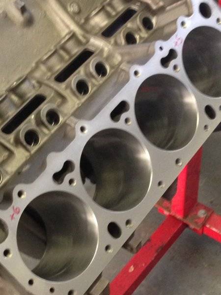

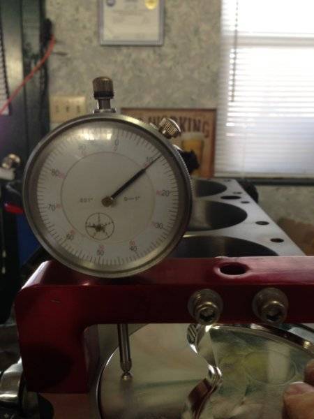

My best guess is that they did it to lower the compression a little. The kit says it should have a compression ratio around 10:39:1 with a 78cc head and stock deck height. I'm using TF 240's and a lot of people say they usually cc around 76cc. We also took .010 from the deck so that will raise it even more. I'm at seal level where I live and our fuel is crap! So my builder said we are going to be right on the edge. The only other thing I can think of is my block had three cylinders that had to be off set bored. So maybe it was for head interference? That's just my guess I will find out tomorrow.
I am using the .051 head gaskets. .005 out of the hole on the 512 from 440 source. certainly wouldn't mill the pistons.
