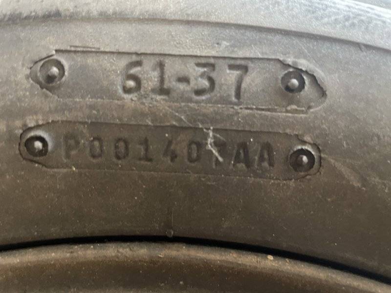

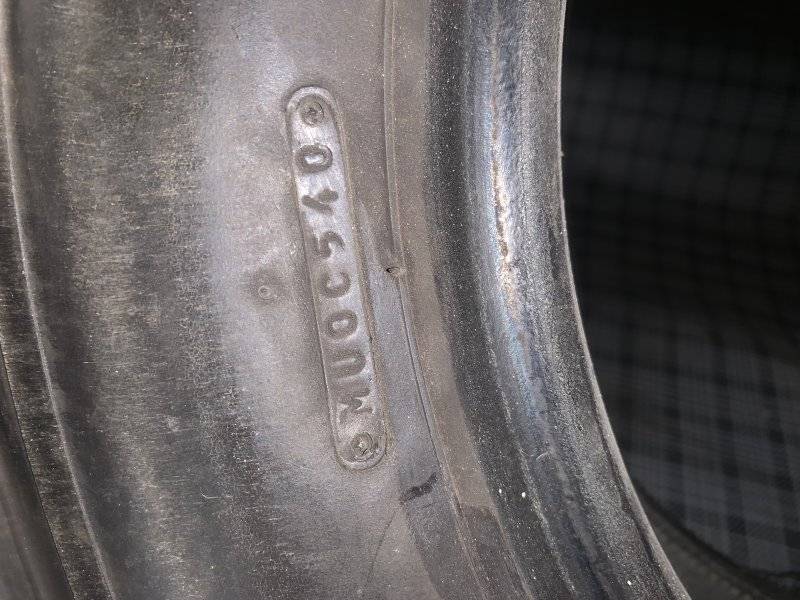

Were Dunlops ever standard equipment tires on an early 1968 build (8/67) and can this date code be deciphered?
Thanks.
not a valid code.. if it was, it was built the 61st week of 2037, DOT date codes only started in 2000
Dunlop are not original tires to a 1968 mopar.
That's what I thought, but I wanted to make sure. Thanks for verifying.

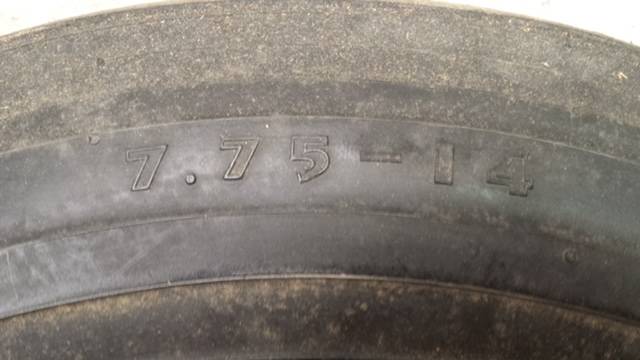

What would be a good modern replacement size tire to fit on the original rims? The tires that are on them are 775-14.

225 70 14 I think is the tallest modern substitute
not a valid code..
I suspect it is a valid code.....it's just that we don't know how to decode it.
You probably need to buy the Cornflakes with the Free Super-Spy Decoder Ring mail-away gift.
I bought BFG blue streaks for 775-14
Purely for the oe look

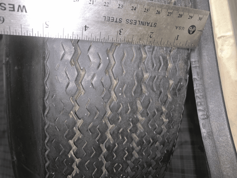

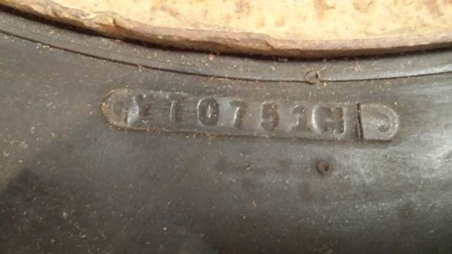

This is the original 775-14 date coded 1966 spare:
That’s a tough one. No one makes a good looking 775-14, everything out there has the pie cutter sides and they don’t look right on a 67 R/T IMO. F70’s in radial repop would work. P metric is 215/70 equivalent.

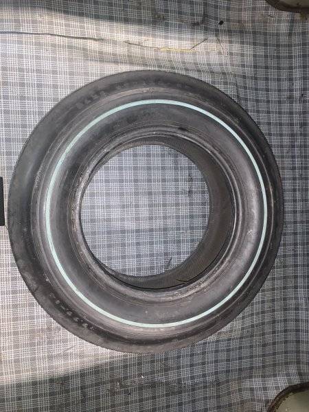

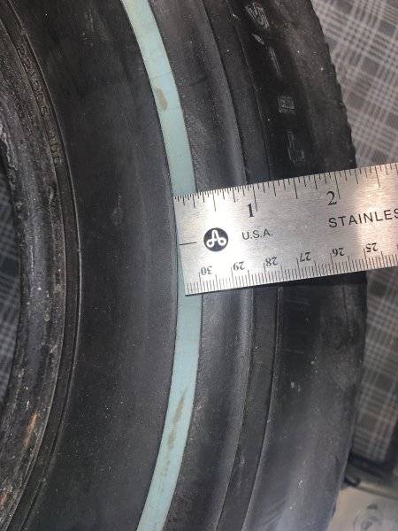

This is the spare in my '66. Looks original, but I don't know for sure. It’s not a blue streak, but probably should be.
This is the spare in my '66. Looks original, but I don't know for sure. Looks like possible remnants of a blue streak, but it's mostly white. It looks more like the blue protective coating on modern tires that's worn off, but was that used on bias plies way back when?
View attachment 1912326View attachment 1912327View attachment 1912328View attachment 1912329
Are those pictures of two different tires? The first one looks different.
One says 7.75-14 the first says 215/70/R14
I always remember bias ply tires being labeled with a letter or number. Like a E78-4 (or ER78-14 for radial) equates to P205/70/14.. It was always cool in school to have a set of Pro-Trac L60-15's on back of your car, mostly cause you were 17 and having a car with a jacked up rear made it look fast.. I'm not sure what year they switched from fully numbered to letter/number combo to finally the P series.
Yes, you’re right! I forgot the whitewall is one of the radials that was on the original rims. I got mixed up when looking for the pics of the spare. I edited that post to be more accurate, now. I’m easily confused these days. :realcrazy:
