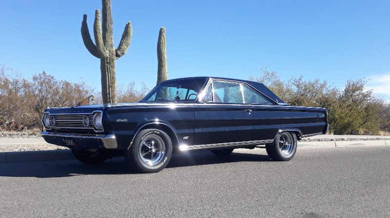

How far did you drive the car? Had a pickup years back with Good Years on it and if the truck sat for a week, the tires would flat spot. If the weather was cold, it would drive like your daughter's Jeep all the way to work which was 15 miles away. On the way home it was better but still a bit Jeepy feeling lol. Next day it was fine but I got tired of dealing with them and changed them out. If you didn't drive your car very far, try it. Keep your speed down though and keep your feel attuned to them for a change for the worst. Usually when a tire is about to give up the ghost, it'll let you know. You could jack up the car and check for tread separation while turning it. It'll show the flat spot too or it should show it....The tires on my Charger are new, but they are 8 years old, and the car has been sitting for all those 8 years in a hanger in N.J. never being driven. They are BF Goodrich Radial T/A's. P 225 60 15's. This is really an opinion than a tech question, but would you keep them or replace them? The car does feel like I'm driving my daughter's jeep, Renegade. I guess really, I just need a push to spend close to $1000 on something that technically are new.
