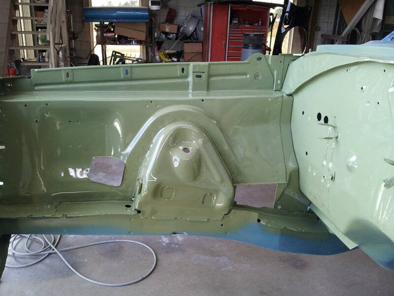

I used KleanStrip green Phosphoric acid on my car as a prep before Epoxy. The engine compartment was soda blasted
because I didn't want to warp the crap out of the firewall. I simply sprayed the acid on with a Zep bottle sprayer and
let it sit for about fifteen minutes and then wiped it down with damp wrung out towels. Blew it off with compressed air
and Epoxy primed it. This is what it's supposed to look like if done properly. If there is any powdery residue left, you
left it on too long.View attachment 1220498 View attachment 1220499 View attachment 1220500
