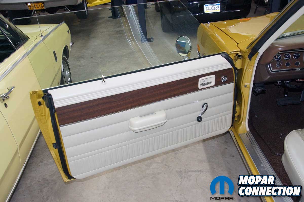

would anyone have video for door weatherstrip install on B body? I searched the web but nothing. I didnt remove mine and bought new but the piece that screws on makes no sense. I do not habe my windows or vent so maybe thats why it looks different
The weatherstripping isn’t too tough. COUNT THE HOLES VERY CAREFULLY. The clips break if you try to reposition the seal. I started on the bottom of the door and worked around each direction inserting 1 clip at a time. I ended up “slightly stretching” the seal on either end (maybe 1/2”) so all the clips lined up with their correct holes. There is 1 small screw in each end of the seal that screws into the door itself
