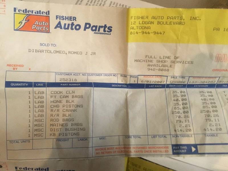

View attachment 587363 Here is receipt
Looks like Fishers Auto Parts did work or subbed it out.
That was originally Automotive Supply until they were bought by ( Federated) Fisher Auto parts,Automotive had been around since the 50's,did a lot for me,you should have no problem with their work.The fellow's name on your invoice is a personal friend of mine,talk to him at least twice a month,if you want a phone number,PM me,he would be more than happy to talk to you.
