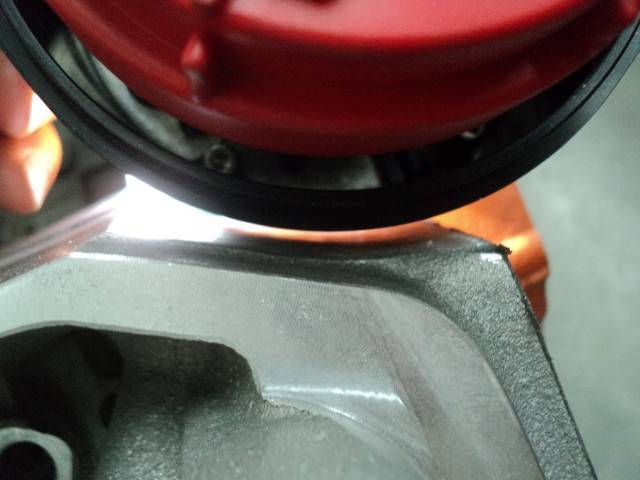

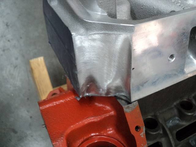

The E-Street's only require what I would deem "very minor" clearancing to clear MSD Distributors, we do it all the time.
And although we haven't checked the Holley Dual Sync version, you may wish to check with MSD and Holley to see if the Diameter of their Dual Sync Dizzy is similar to the MSD "Ready to Run"/Vacuum Advance Units ? which don't fit OOTB either.
Here are some Pics, pretty easy-peazee clean up to work.
The clearancing is basically required, and starts about 1-1/2" UP from the Head Deck.... plenty of meat there to work with.
