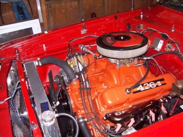

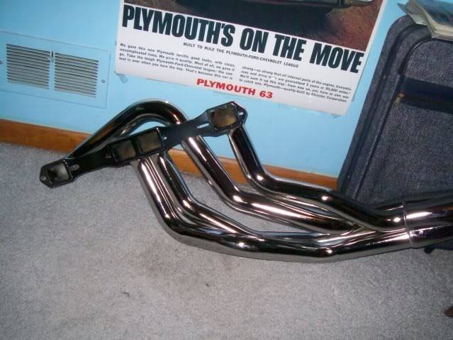

What are you 62-65' guys that have an RB motor with max wedge head ports and manual steering and brakes running for headers? Can you post pictures?
I have been thinking about replacing my headers and looking for some options. I would really like SS headers with at least a 2" tube and 3.5" or 4" collector but not sure what's out there these days. I currently run a set of ????? that have 2.25" primary to 2.125" into 4" collectors with the collectors that slip over the tube ends. This set has the front and back cylinder tube separate from the middle two and the back cylinder wraps the frame. I am looking to replace for two reasons, one is apprearance (these are painted black steel and are a PITA to keep nice) and secondly I'd like to go to a set with a welded on collector to try to reduce fumes in the cockpit.

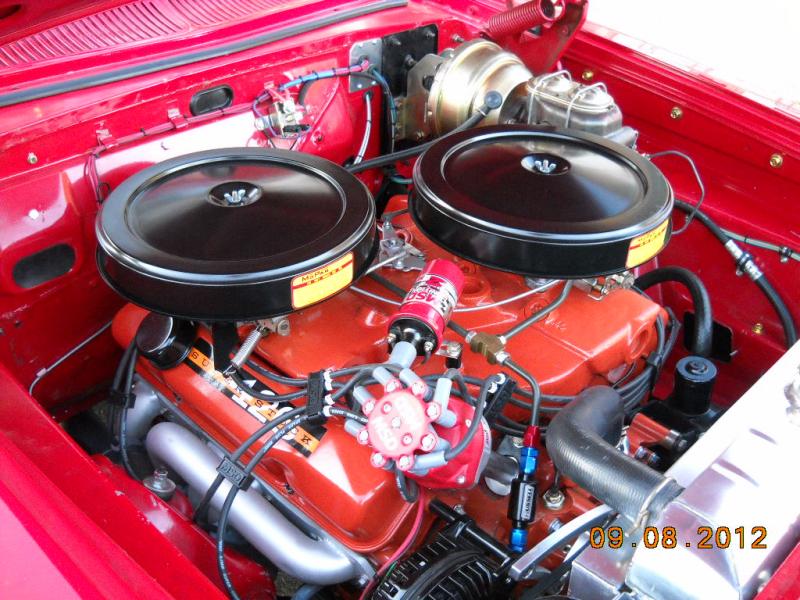

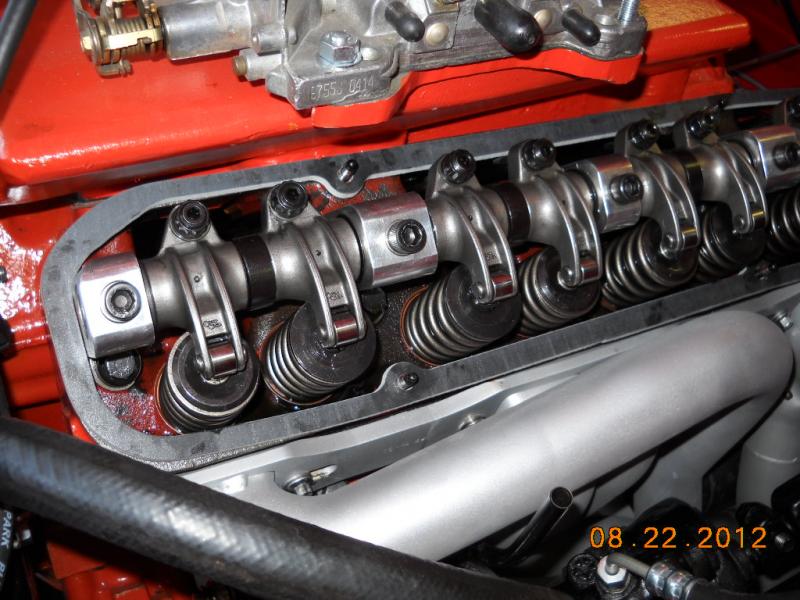

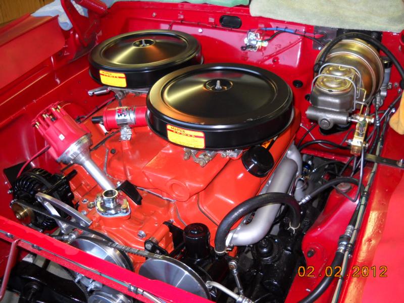

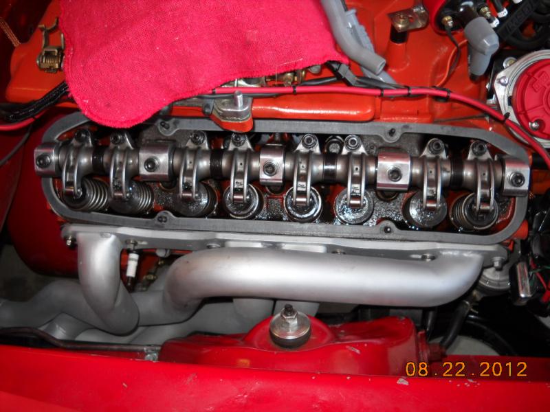

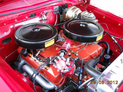

These are CPPA (early TTI) 2" into 3 1/2" collectors. Power brakes, power steering. Tight fit at pitman arm ( had to cold bend arm to gain clearance) and mini starter. Other than that, no interference problems. One piece, no leaks.

Coloradodave - thanks for the pictures. How is plug access with these? Is that ceramic coating? I can't see your steering shaft in the picture - no problems with it? Can you get these on and off without lifting the motor?
Dang Dave. That is super beautiful. I'm droolin.
Hi Dave, awesome pipes...may need these ones myself. They look great, are they still available from tti?
Coloradodave - thanks for the pictures. How is plug access with these? Is that ceramic coating? I can't see your steering shaft in the picture - no problems with it? Can you get these on and off without lifting the motor?[/QUOTE)
Plug access isn't great. I heated the pipes and gently 'massaged' them to gain extra clearance. No problem burning plug boots now. The finish is VHT flat aluminum paint. Cheap and holds up really well. No problems with steering shaft. Don't have to lift the motor to remove headers. Just drop the tie rod off the idler arm and get car up 18" or so. Keep in mind that these are EARLY TTI. They have updated them to clear the pitman arm, and yes, crossram426, they are still available.

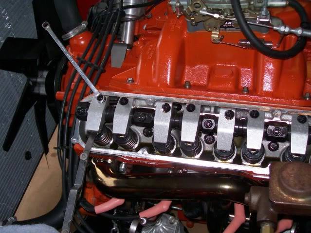

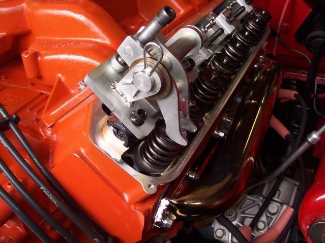

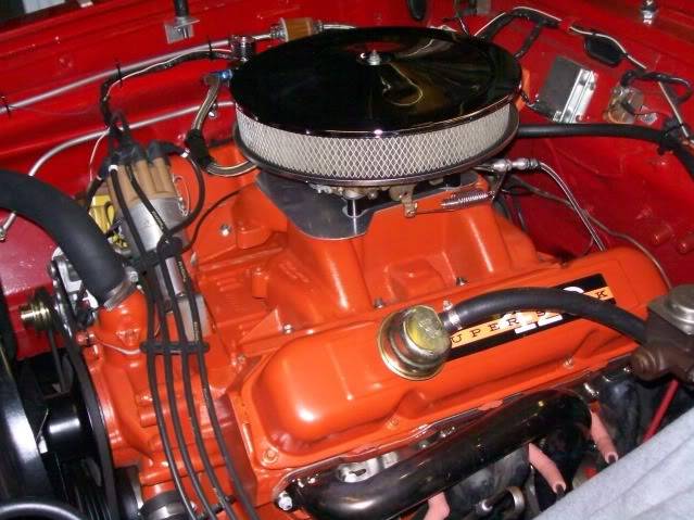

Here is a few more pics of my 2" TTI's. Ron
I really dont have any good pics of the pass side. This while installing the eng. Ron
Last one. Ron
I found one more that gives you a good idea of how thick the flanges are. Nice thick flanges that never warp. Plugs are easy to get to but these are angled plugs in the Indy EZ heads. Ron
I have 440-1 heads on mine which also have angled plugs and the max wedge ports. Manual steering nd brakes. I definitely don't want to drop below 2" tubes, preferably staying a bit over. I think I'd like to try some SS headers too. I've had bad luck with all types of "header paint" and from what I ready online the ceramic coatings are not that durable either.
