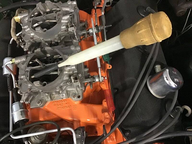

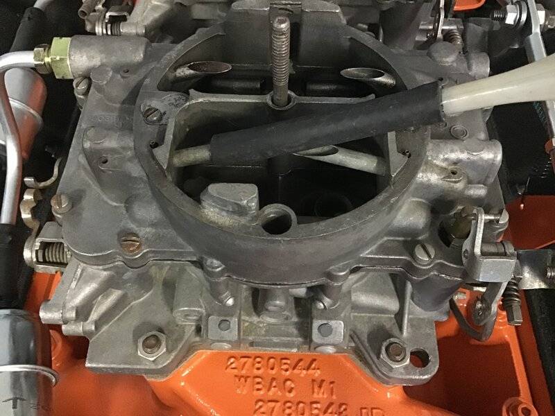

A turkey baster with 1/4” hose on the end. This one is old and the gas doesn’t melt it. I have a copper tube with the end flattened I put in the end of the hose To fill the bowl vents on AVS carbs.

Great ideal with turkey baster
