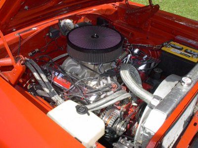

I used the high temp silver on my intake manifold...I'm happy with that
