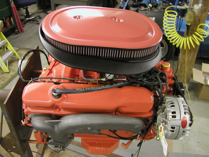

@ mopar and missles thats a beautiful motor
