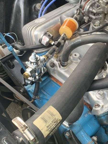

Today I buttoned up the fuel line. Pressure regulator and gauge. I set it between 4 1/2 - 5 psi. It seems to have worked. I took a long drive in the muggy New England heat. 1 1/2 hour trip each way. No issues.
Have any pictures of that set up?
Thank you. Having some issues myself.
