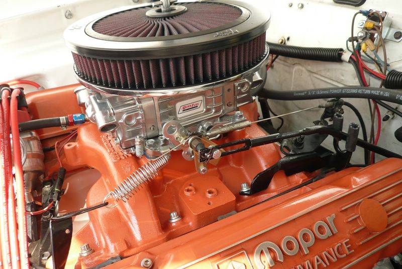

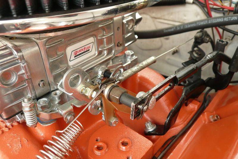

This is my current setup:
The intake height is about an 1" higher than the stock cast iron one.
I`ve been reading instructions how to adjust the kick down a hundred times (really!)...tried so many adjustments but it still starts to slip under high load.
Do you think the intake is still too high and the linkage geometry is wrong?
Is there anything I can do about it?

The good news is I'm running the performer RPM manifold plus a 1" carb spacer and have plenty of adjustability in the OEM kickdown linkage to get it right.
Wait, just read it again I don't have the '65 1 piece kickdown rod. Sorry.

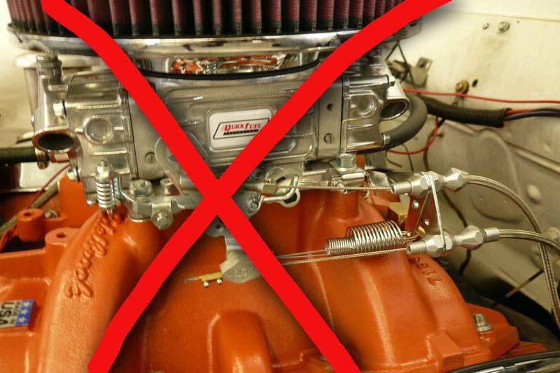

Question about the Lokar kickdown cable - in the picture, it is connected to the carb linkage at the BOTTOM of the linkage, which means it will PULL on the cable as throttle is pushed. Th oem is hooked at the TOP, meaning it will push on the eom rod. Does the Lokar account for that down below or is that hooked up wrong for a mopar?

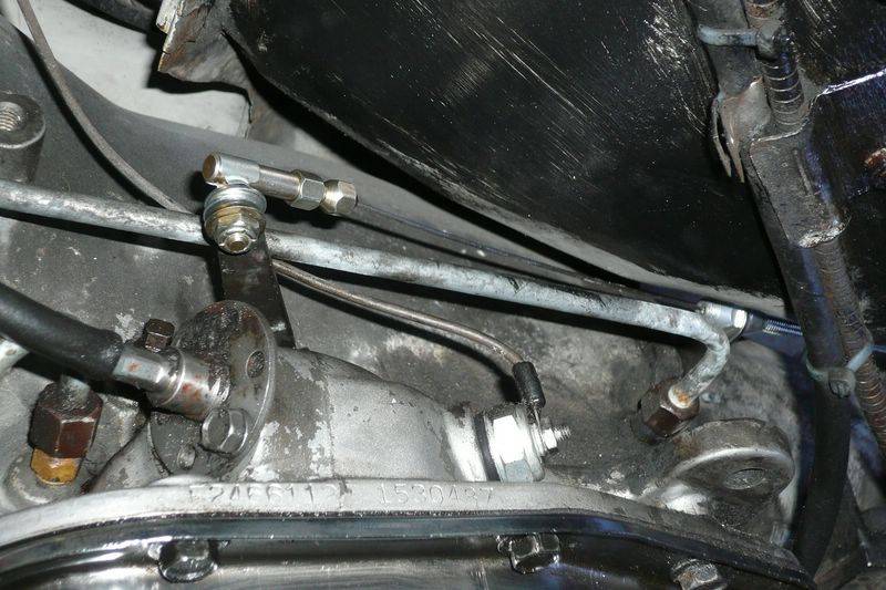

You are right, with the Lokar cable it pulls the lever (see pic), but forget Lokar it is history already.
Lol, it's 7:30am over here. Not sure I'd forget the Lokar,if I were you. It just seems to me if you didn't modify the linkage down below for the cable pulling vs the rod pushing, no way the Lokar would work. In other words, it might be that simple of a fix.

The cables pull the kick down back from behind. The rods push the kick down back from in front. To answer the question, if the kick down is all the way back at full throttle that's good. But it needs to start pushing the throttle pressure valve in at about 1/2 throttle. In other words the pressure valve Don't start to move in the trans. Until about 1/2 way. Maybe 1/3 (don't have one in front of me now) The first bit of travel of the trans end kick down lever is not doing anything. So you want the kick down all in @ full throttle, but you you don't want to start pushing the valve in the valve body too early or too late. At moderate throttle 1-2 @ about 17 mph. 2-3 @ about 27 mph. Hope I didn't confuse anybody.

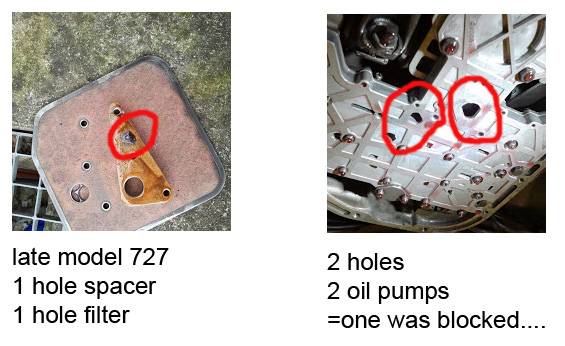

we (unfortunately) found the problem :angry1:
The transmission shop used a late style 727 oil filter spacer and blocked one of the two oil pump channels!!!
But now its too late, front clutch is toast and tranny needs to be rebuilt....which is really expensive over here in Germany.
Dan

The OEM linkage was adjusted correctly, at WOT the trans lever was approx 97% all in.
But with one of two pumps completely blocked there is nothing you can really do.
We increased the line pressure yesterday by turning the screw 2 turns ccw, but it did not help to rescue the 727.
In addtion to that we also drilled a hole into the spacer for the 2nd pump....too bad we didnt find the problem before.
