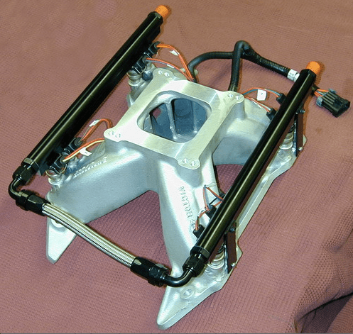

Contact Rich @ Fastman EFI

As noted by 1 wild R/T, call Fastman EFI for an intake like in the photo.

What 451Mopar said, the pads on the single plane are for nitrous. There are to parameters that need to be met. Injector bungs will need to be on exact same horizontal plane and injector rail needs to have injectors at same spacing. A "Good" machine shop could do it. But I'd rather not reinvent the wheel, Fastman EFI has already done it.

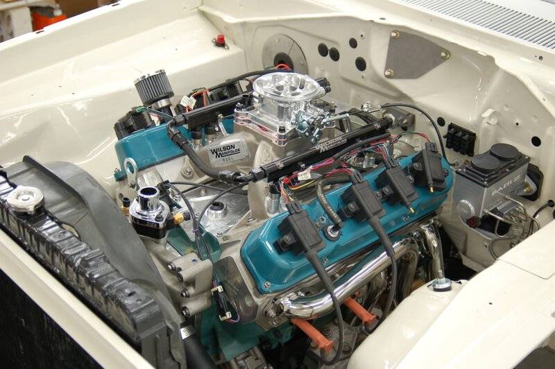

At the moment nobody does an off the shelf low deck standard port EFI intake. The Indy intakes can be easily modified for port injection by drilling the bosses but their intakes are all MW size. So if you really want port injection on a low deck you have to roll your own. Not that big of a deal really, just call Wilson Manifolds and give them a credit card number and you'll have an intake in your hands within a few weeks. I have a Wilson intake on the low deck 512 in my Duster. It is a super high quality setup but it will cost you some money.
